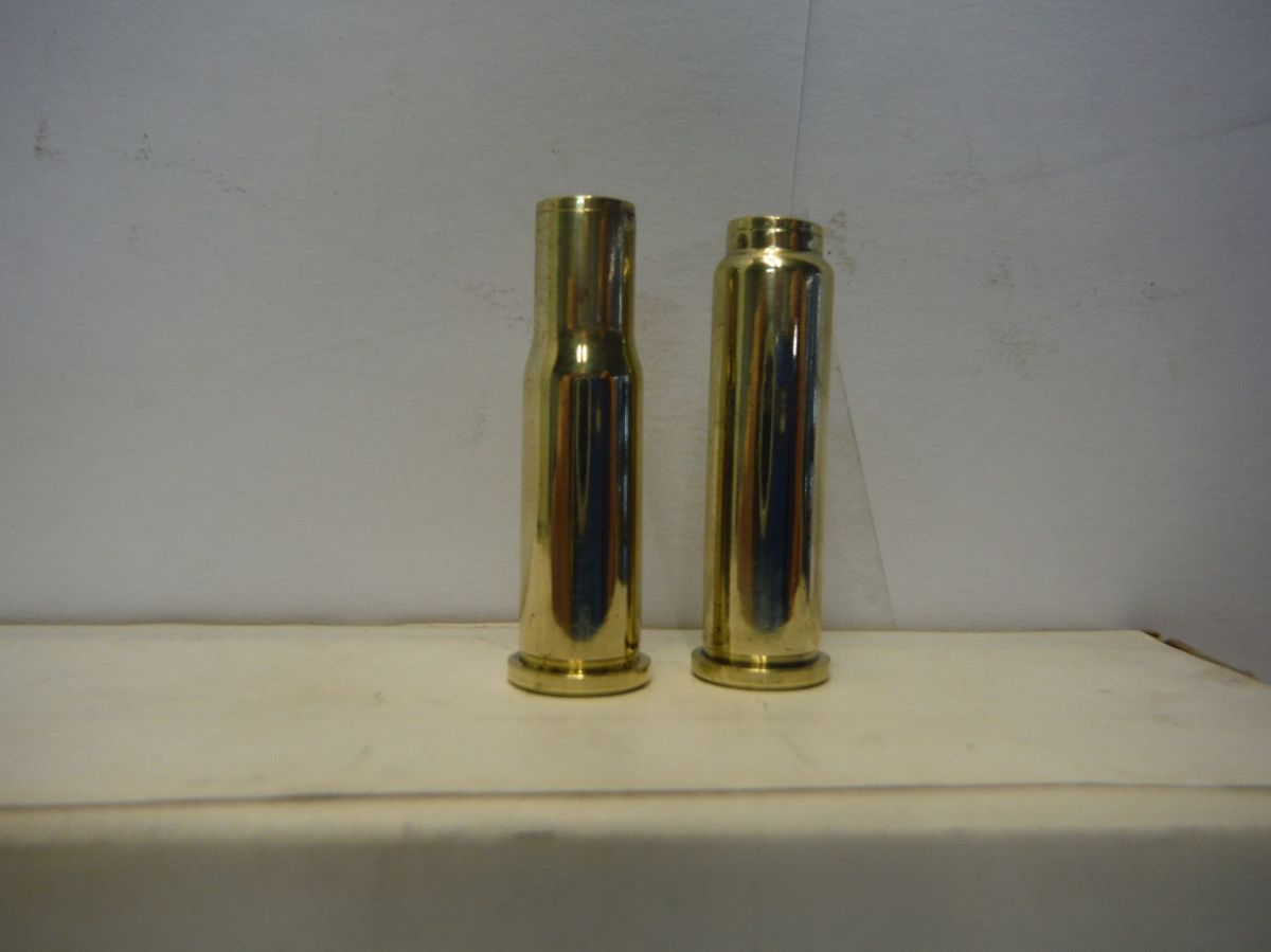

the 25-20 on the left,
251 Falcon on the right,
but the reamer was made off specs. I asked for a .175 length neck. We got a .086.
So the reamer has been sent back and will be re-cut to a .175 length neck or somewhere in that area.
So the neck will be about double what is shown in the pic. Even with the longer neck the total case capacity will be considerably more than the parent 25-20 case.

The 251 Falcon will be another build...
