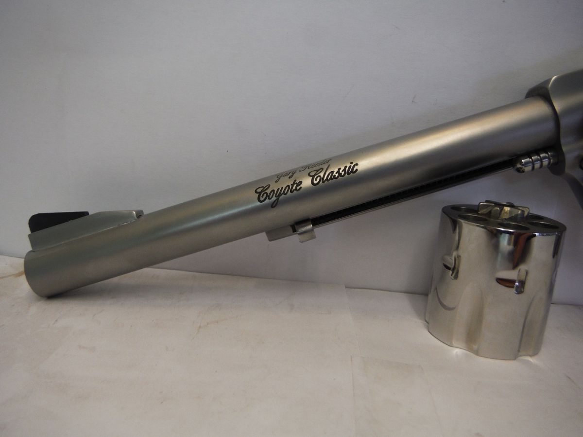

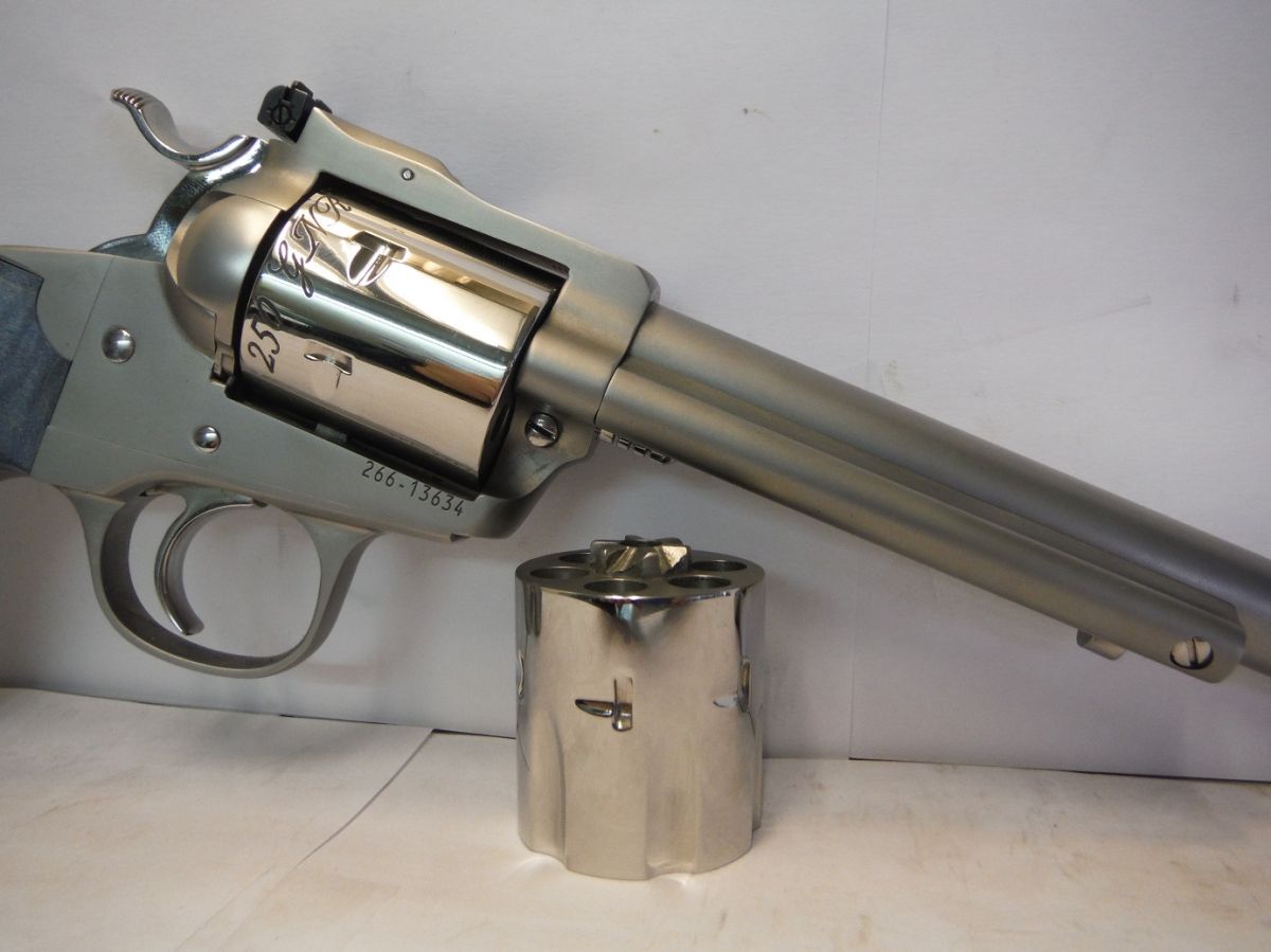

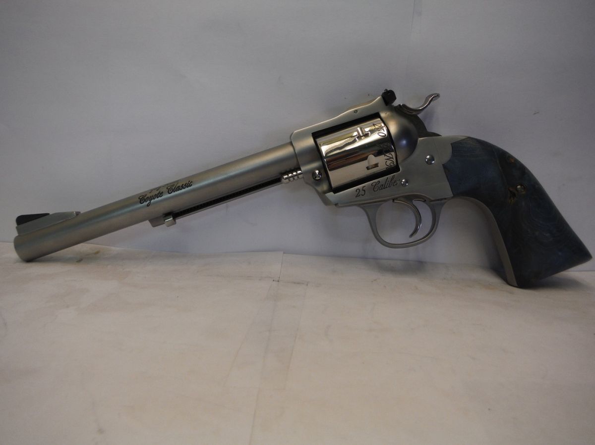

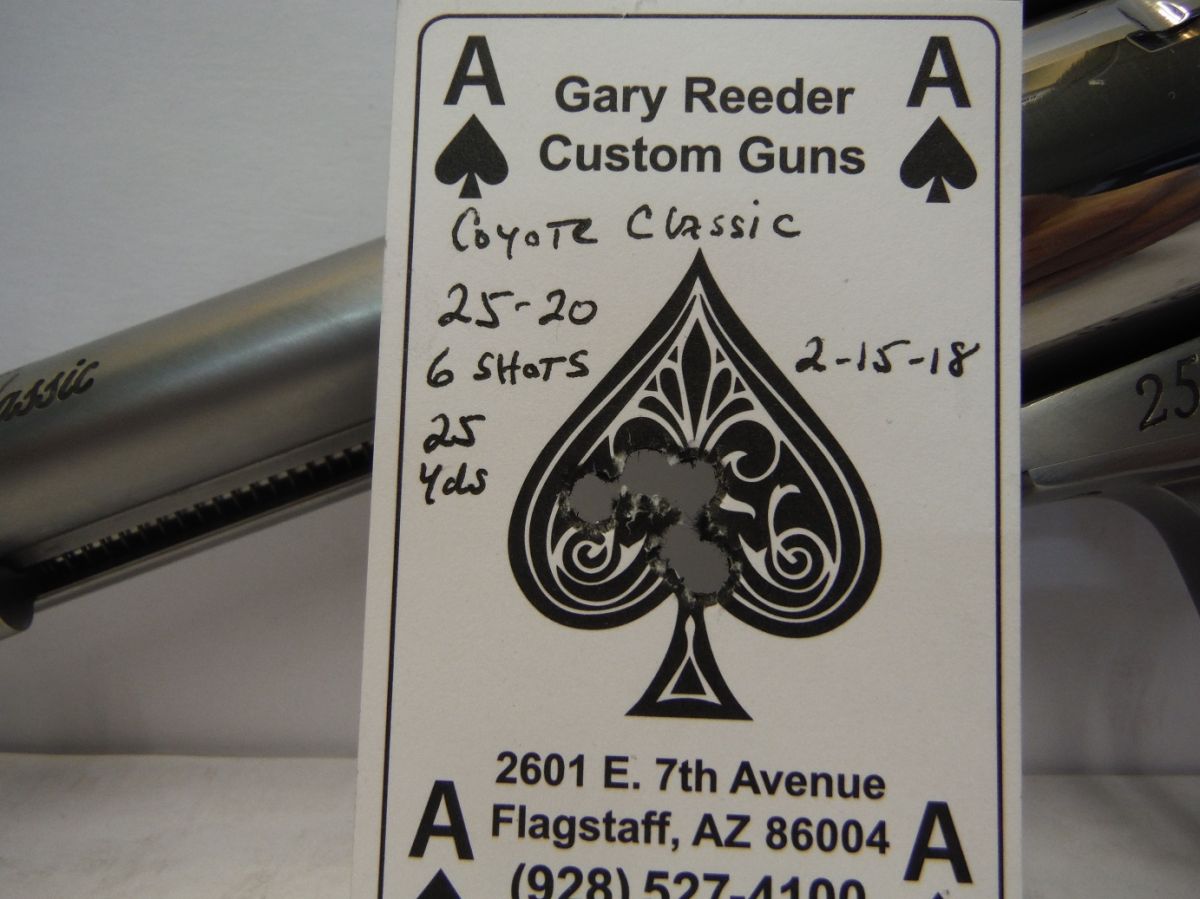

So far this morning I've loaded with three powders and four bullets. I've not experienced one single case to give setback issues.
This gun has even passed the ultimate test of fast burning pistol powder. These powders are notorious for setting back cases before they expand to grip the chamber walls. Not so with this gun.

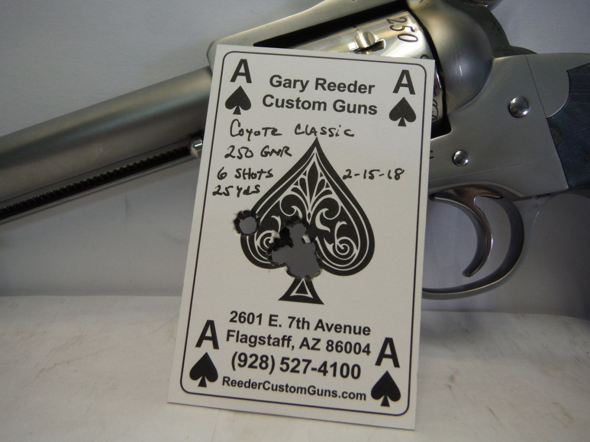

Unique worked so well in the 250 GNR, it was my first choice here too.
5.0 grns of Unique behind the 55 grn GT Cast HP produced 1390 fps. All but one bullet made a single hole at 25 yards. Including the flyer, group was under 3/4"
Cases fell out of the chambers and the barrel didn't show a hint of leading.
The saga continues...

For years I've been told the 25-20 wouldn't work in revolvers. But, I couldn't ask for more than this gun offers.
I think the success comes from very tight cut chambers. The brass expands very little before it contacts the chamber walls. This happens before the case sets back.
This gun has instantly became Revolver #1 in my collection.
