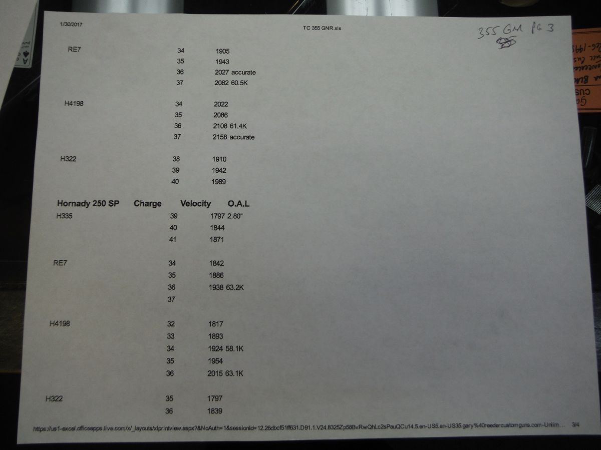

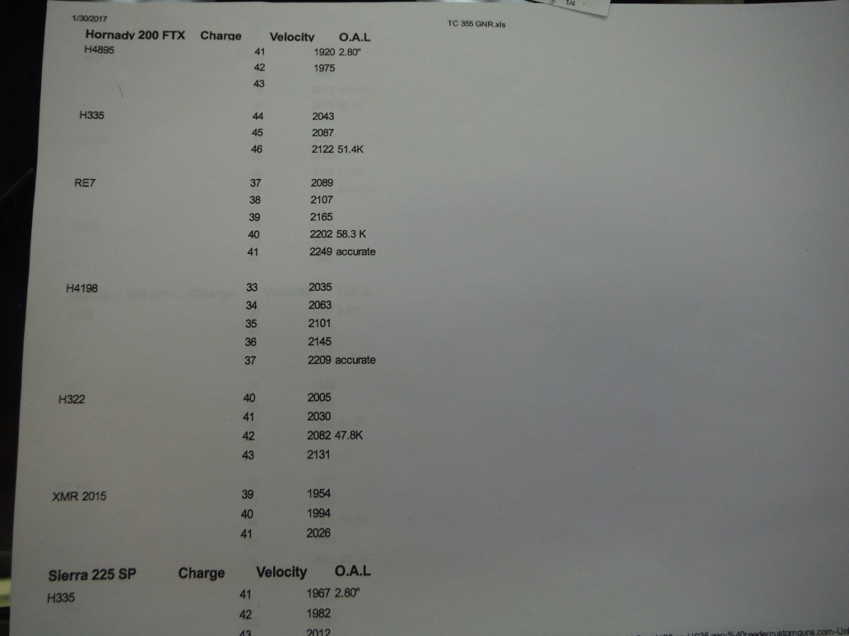

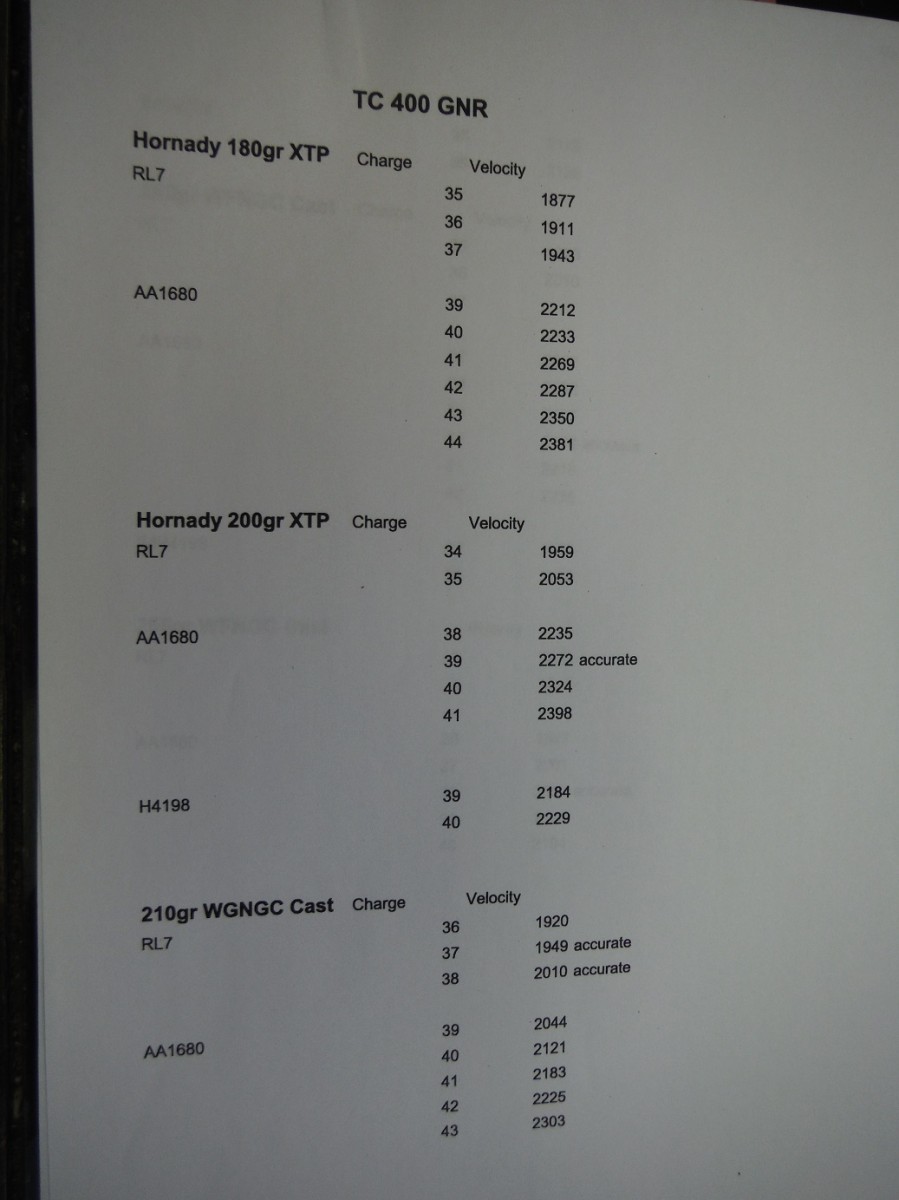

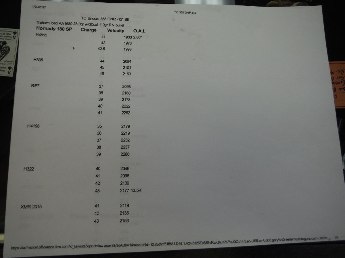

They are close enough..same base case. Different bullet weights but you can work with these.

start with the 400 GNR or the 355 GNR data
