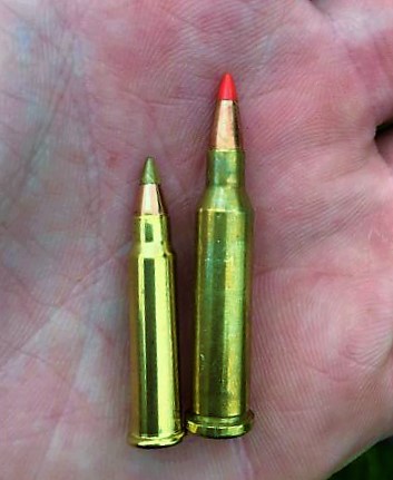

I have a .17 HMR TC handgun barrel. It is so much fun shooting the 17 gr. bullets at 2500 fps and when they hit, no worries as they come apart pretty well.
Being a TC tube though I began wondering what's keeping me from re-chambering it to .17 Hornady Hornet, .17 Ackley, or even .17 Ackley Bee?! I can rent the reamers myself and do the work. That's some dangerous thinking...
The 20-25 gr. bullets would perform better from the 14" pistol barrel too. I wonder what it could do? Best I could manage from the .17 Remington was 3300 fps with a 25 gr. in a 14" TC. The rimfire at 2500 and 17 grs. is not too bad itself. I may need to chrono those 20 gr. from it. Would 5 gr. more bullet and 500 fps be worth it?

The Hornet works very well with the 20 V-Max and AA-1680
None of them fly apart unless you hit something. When you do, they almost always stay inside the critter. The critter usually sounds like a sack of Jello.

3650 with 8.2 Lilgun is what I'm told. Brass is the 4.6x30 HK which is very consistent and high quality. Duplicates the 17 Hornady Hornet with less powder.
Good ballistics, such a small charge too.

Researching I have come to the conclusion
Wednesday, March 28, 2018, 08:07 (3153 days ago) @ WB
that IF I wanted to go that direction the old .17 Ackley Hornet would be the ticket. It has notable more capacity compared to Hornady's new Hornet and can fire that factory ammo forming to the larger chamber. A win-win, also available to anyone with a .17 Hornady Hornet, provided the magazine can manage it, but I'm sure many won't.
