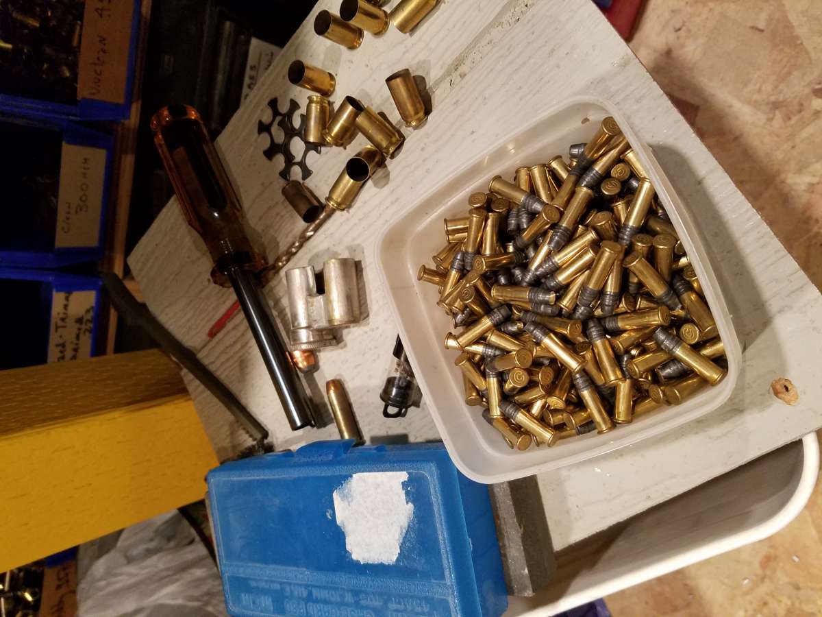

We're getting ready for the annual trek to Nevada for ground squirrels and I'm prepping a couple bricks of ammo.![[image]](images/uploaded/201804060310565ac6e540a2b45.jpg)

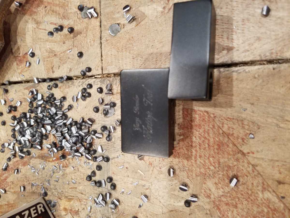

![[image]](images/uploaded/201804060312065ac6e586c61f3.jpg)

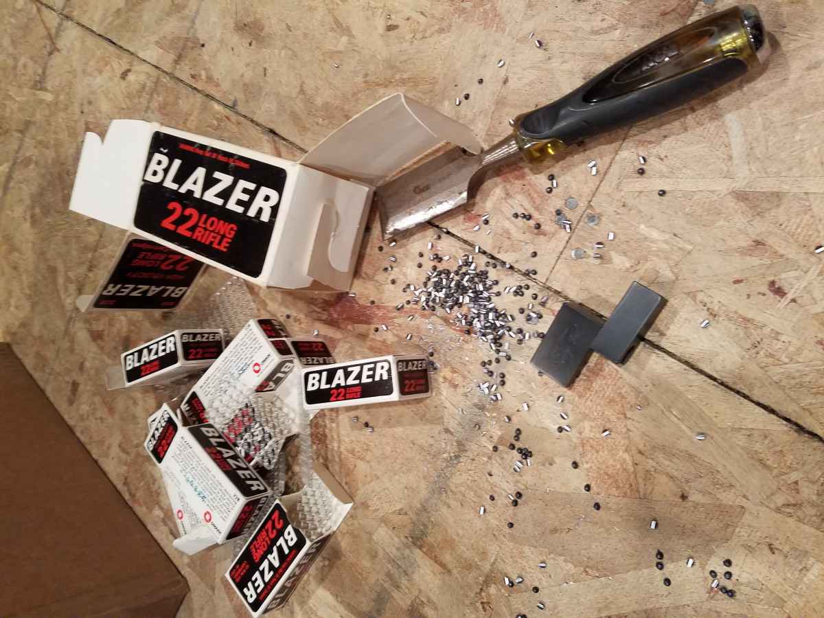

![[image]](images/uploaded/201804060312575ac6e5b9edc54.jpg)
James, I notice you are using a chisel, are you doing it
SPB
Friday, April 06, 2018, 06:43 (3144 days ago) @ James Simpson
with hand pressure or the assistance of a small hammer. I have a very hard time getting a square cut. Any guidance appreciated. Steve

I think that's what he's using.
Randy Barnett
Friday, April 06, 2018, 09:06 (3144 days ago) @ ORG
the second pic shows it better
Friday, April 06, 2018, 16:51 (3143 days ago) @ Randy Barnett
Just pushing with my hand.

Friday, April 06, 2018, 16:28 (3143 days ago) @ SPB
Gary had suggested a utility knife , but this works so much better. Shoving it against the floor takes the work out of it for me. Besides, I want to have over 1k of ammo done.
