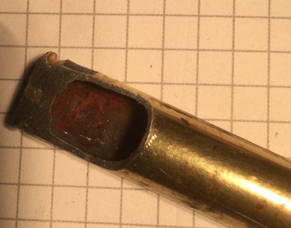

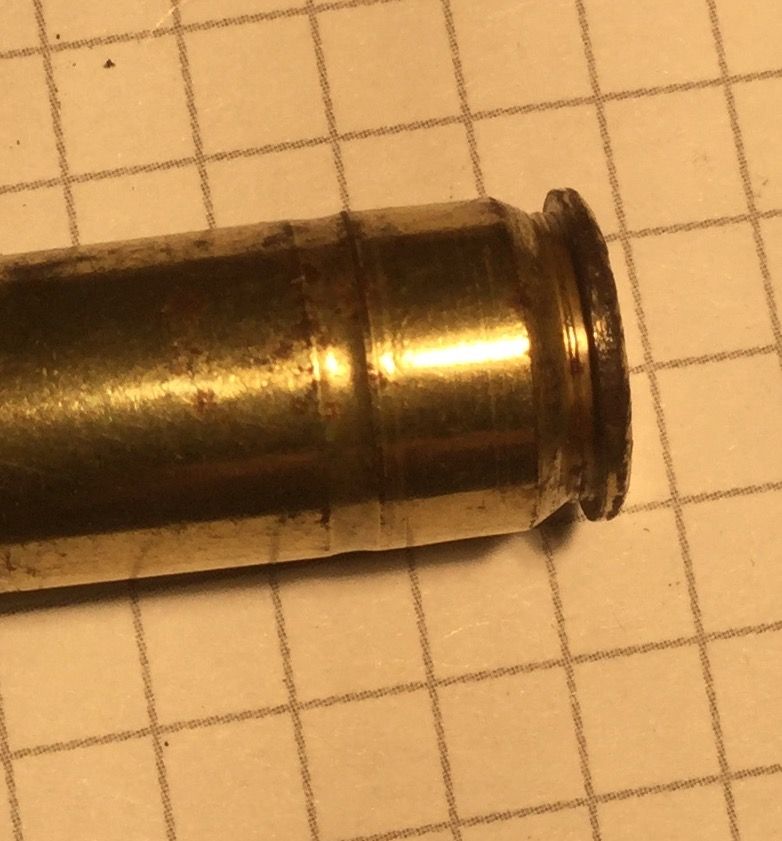

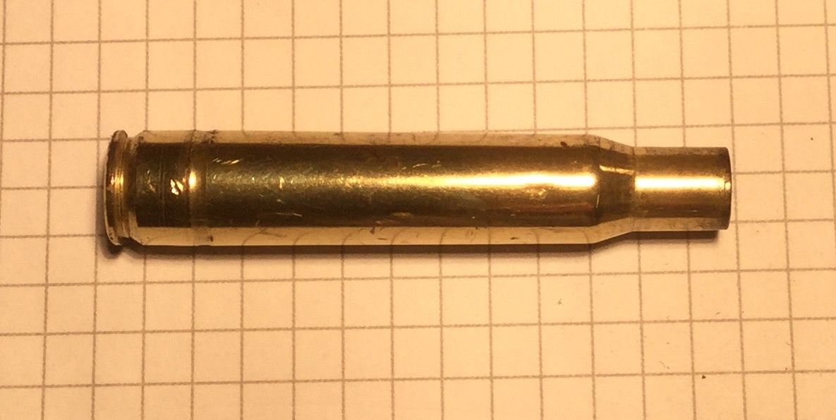

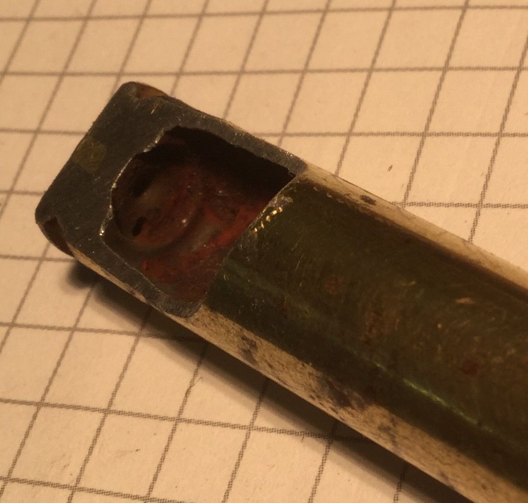

At the range I picked up an odd cartridge,.... 30-06 but weird looking.

It had that weird ring around it. I discovered it was a plated steel case ... Berdan primed. I ground the back open and the ring does not appear to be from excess case lengthing, but was made that way.

Just kinda wondering what the deal is with that ring on the case.

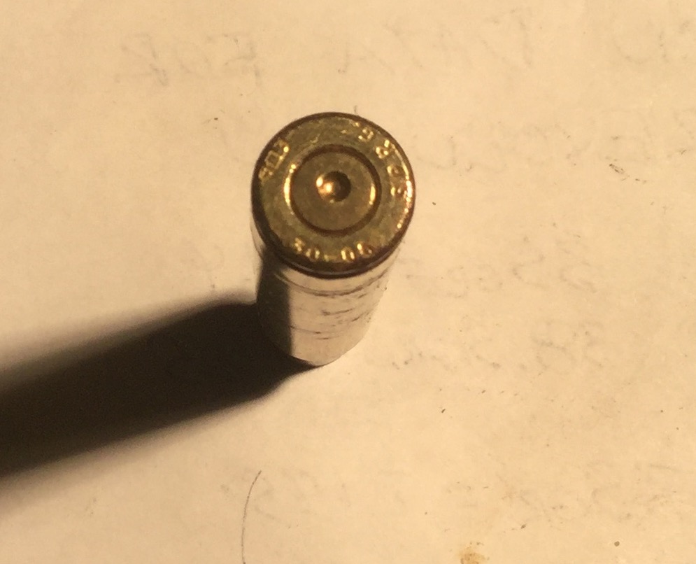

Headstamp
Friday, April 27, 2018, 10:32 (3122 days ago) @ Jim Taylor
Forgot to post the headstamp
![[image]](images/uploaded/201804271732405ae35eb8c35f5.jpg)
Does not look like separation. Will be interesting to see.

It is Russian made by this company
Amede
Friday, April 27, 2018, 12:59 (3122 days ago) @ Jim Taylor
This one was Russian made by Barnaul Cartridge Plant.
The groove is stretching out from the gas pressure and is adding length to the case below the obturating upper part of the case. This is a small safety against case head separation.
Mic McPherson said same thing.

Found (2) good pix of 'ring'
