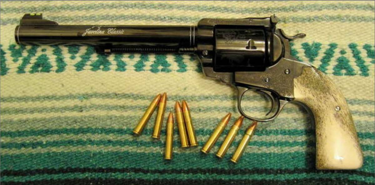

I have a large frame gun, .44 Mag. actually
Sunday, May 13, 2018, 19:14 (3106 days ago) @ Paul

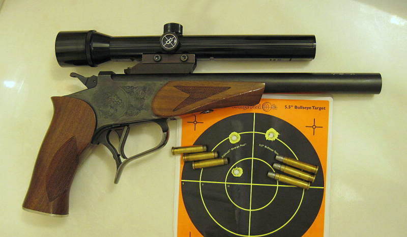

that has been skillfully adapted to a 8-shot .255. I think the late .357 chassis would be a little more handy in retrospect. It sure holds steady and shoots well. The Contender barrel is a custom 10" on a 1974 chassis set up old school with 2.5X scope. This is a 100 yd. group. Velocity is about like a .22 WMR rifle while shooting 80 gr. bullets. They have some whack.

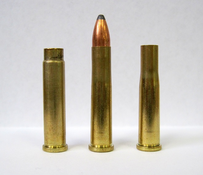

This is how you do it. Run a .22 Hornet through the .255 sizer to expand to .257", then load a .25 bullet this is a 60 gr., a fire formed case.

Keeping in mind that formed case is the same length...
Huey
Sunday, May 13, 2018, 19:34 (3106 days ago) @ WB
As a 25-20. The necking up and fireforming shortens it a bit.

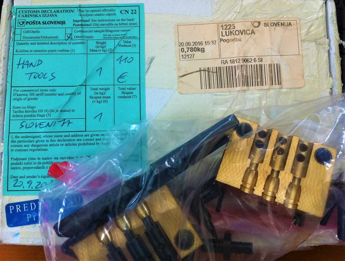

have not yet used my beautiful mould. It makes FNGC plus about (3) different versions of HP cavities. I think 60 gr. in .257". I always wanted a (3) cavity mould to play with. It's almost (almost) too pretty to use, like Melania!

I have to admit I too have not had a chance to use
Monday, May 14, 2018, 12:45 (3105 days ago) @ WB
the same mold that I got a year or so ago. There just doesn't seem to be enough hours in the day anymore.
