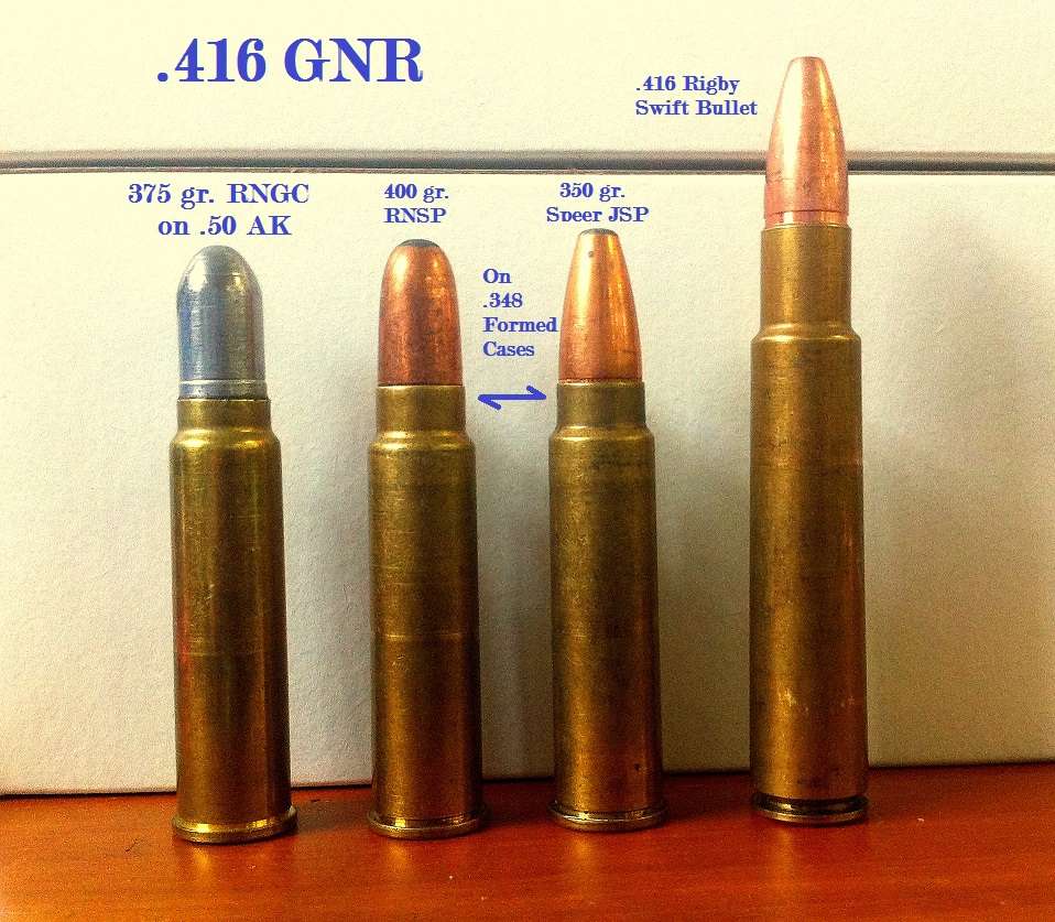

Any of the GNR's on the .348/.50 AK case are tops. The cases can be a little expensive but last the longest of any of my GNR cartridges. I use Winchester .348 brass, it's the easiest for me to fireform. Sometimes a little trimming is required but that's it. Better to have too much than too little. I make a .348 Winchester blank by filling the case to the neck with fast pistol powder and using tissue for a stopper so I don't spill it. Speer makes a 350 gr. .416 bullet that is very effective and economical that will take anything on the planet. Deer/hogs to Buffalo with ease.
You might consider the easy to overlook .440 GNR on the same case, just a little bigger. It's fantastic ability to shoot inexpensive .44 handgun bullets is great. I have been wanting to re-form some .425 Westley Richards slugs into suitable .440 GNR projectiles (410 gr. -.435" to .430"). But ditto, the .476 GNR and .475 pistol bullets and .470 Nitro Express bullets (I have NOT tried the latter but have some). *Gary's .475 GNR uses blown straight .45-70 cases for a slightly less dramatic version too. How bad do you really want to be? I also have not tried the .450 GNR that uses .458 bullets, very versatile.

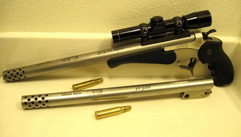

But I must have have confused you. For panache and flatter trajectory, a worthy consideration for a carbine, the .416 and 350 gr. bullets would be great. Mine is 13+2" with a brake (I think). I wanted to mimic Dr. Bill Firman's Elephant taking combo for my own fun. I cast my own .416 325/375 gr. GC bullets and use trail boss for great useful fun. ANYONE could handle those and it would still shoot clean through about anything.
Couple pics
Tuesday, May 22, 2018, 09:06 (3097 days ago) @ WB
I actually prefer the longer necked .348 Winchester brass trimmed to my individual chamber length. The .50 AK case rounds require no trimming other than maybe squaring off for looks. But that is fun stuff. HAWK makes pure copper and lead, jacketed bullets, custom for about anything. They are not that bad pricey. The copper is a little gummy in the bores but they expand and perform wonderfully aside from that.
