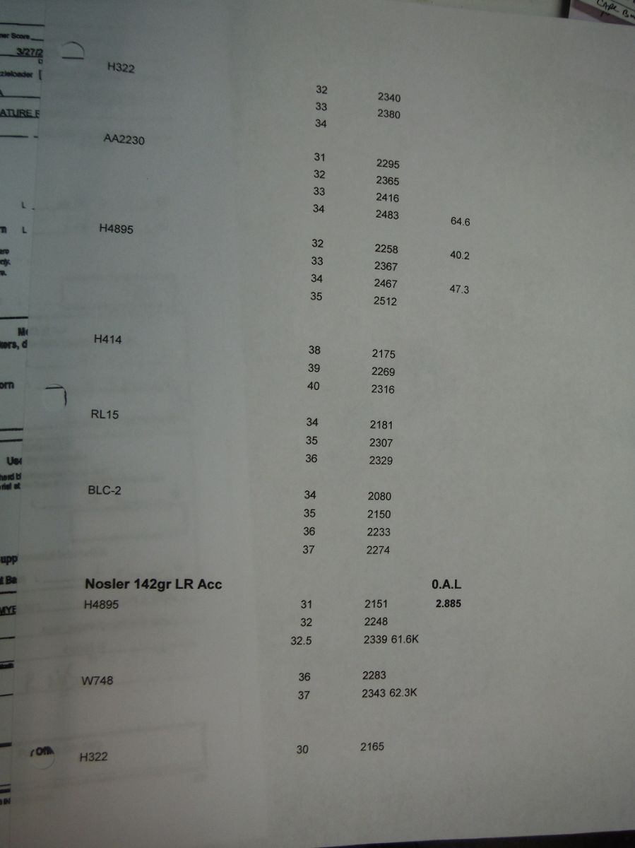

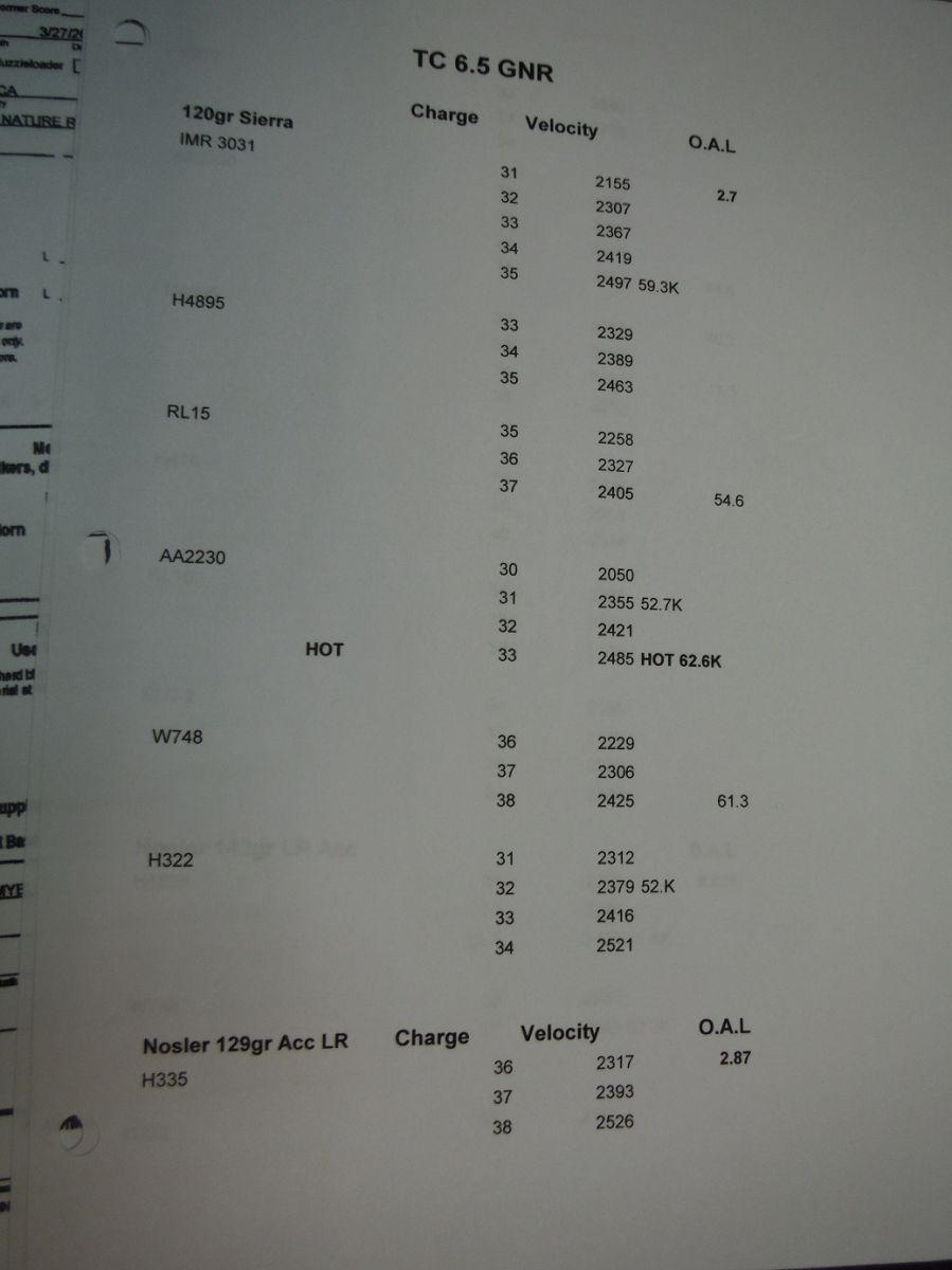

What is the 6.5 GNR based on?

- That frame G-2 oe Encore? (nm) - bigboar, 2018-06-01, 22:39
It is based on the 30-30 case. here is the load data
- Gary Reeder, 2018-06-01, 10:22

- no, any barrel will work with those loads (nm) - Gary Reeder, 2018-06-01, 16:05
