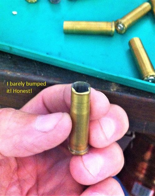

There are a few tricks though. Many folks mention "weak" brass. What does that mean? Some attribute that to some case failure issues but in reality the only "weak" I have found is some old numbers with inherit "thin" brass in the neck area. The .22 Hornet, BEE,.25-20, .32-20 (latter 3 are all the same base case)and .38-40 are mainly front to mind. Just bump the neck and it crumples! Also crimping is very easy to throw up a bulge at the case mouth if you have varied case lengths. You did trim all your cases to the nearest 0.001" right?! HA! Me neither, I just do minimal crimp and run them all, long and short. The .32 WCF does not need much of a crimp. I placed this one in the shellholder and lube stuck to my thumb puling the case back slightly, too late, my mechanized reflex was in motion, mash! I'll trim it back and try to make a .218 BEE.

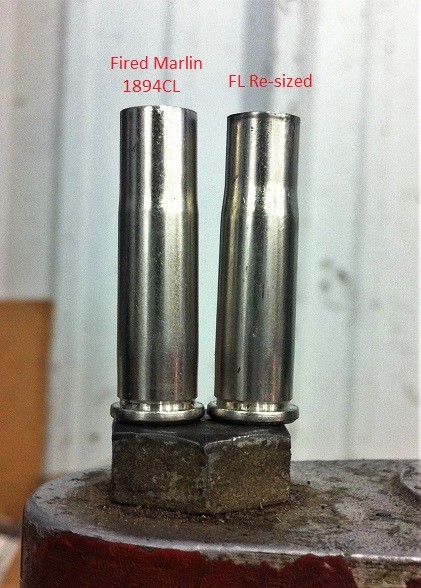

It is odd to me with some rounds, namely to my attention the .32-20, .38-40 and .44-40 that the chambers are routinely "oversize" comparing to a FL sized case! Perplexing for another 150 yrs.? You can see the difference and the 1894CL is not some old worn chambered ranch gun. This trait is dominant in the industry. My fired .44-40 almost look like .44 Mag. or .45 Colt cases, hard to tell at a glance.

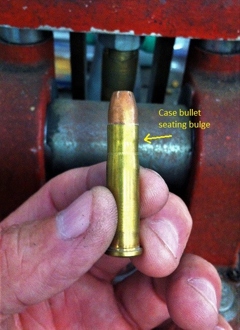

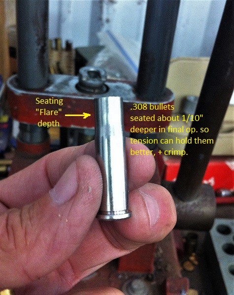

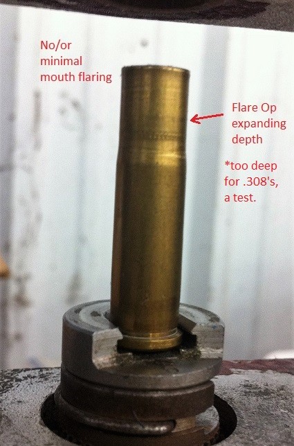

The LEE dies I have gave me some issues at first. I used a "universal" neck flaring tool also by LEE initially. This left the necks very tight at 0.306-0.307" and created case bulges when I seated them. They fired OK though, just looked a bit natty. Then I tried the included "flaring die" in the LEE set. That die does not flare in a conventional manner. It basically irons the neck to about 0.310" with minimal case mouth flaring if I can detect it at all. If you continue to adjust till you see "flare" a 0.309" bullet will drop right through. I guess it is intended for the proper 0.311-0.312" spec. industry bullet. However I can limit the amount of depth I iron into the neck and insert carefully the 0.309" bullets then finish seating to a deeper spec where the neck tension grabs them. I finish with a light crimp where the majority of my brass feels right. Every once in a while I'll feel a short one then a tighter long one but no bulges, I'm good for the calculated shortcut.
