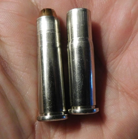

the .32-20 deep seat ammo ran 835 fps / 90 gr. so they were pretty light. Should be 1000-1100 fps. They fire formed funny looking and were hard to extract. I had a little issue with the rims being too thick or maybe the OAL too long. A telescoping firing pin bushing protrudes pushing the cylinder forward against the barrel. Some were too long on some dimension and it would not go full cock. I'm looking into that.

The fired case on the right sure looks odd. The base is much larger than a .32 cal. but the necked area slides into what we normall would call the "throat". A Nagant has no "throat" as the FL case fills it. It's an odd bird.
