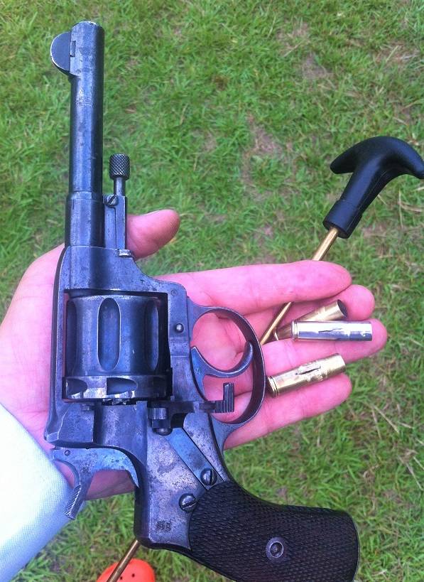

Well 7.62x38R is larger diameter than .32-20
Tuesday, June 26, 2018, 14:33 (3062 days ago)
I cobbled some ammo just so we could play. It shot but fireformed extraction was hard. On the second firing they rupture, just too much movement for those brass molecules to flex. I only reloaded 3 that had been fired previously. I slightly thinned the rims too as some .32-20 were too thick for the spring loaded cylinder to push far enough forward to go full cock. An odd duck.
We ordered some PPU boxer primed ammo and I will get the proper dies. Still great fun for a 107 yr. old SA revolver. (Yes this one is SA, not DA) The factory ammo looks tapered to the end but fired cases, the chambers, look like a case with a neck about mid-way.
That looks like an original finish gun

rather than one of the postwar refurbs. Any chance it as an "SA" in a box on the other side? Possibly a Finnish capture from the Winter or Continuation War.

Tuesday, June 26, 2018, 18:03 (3062 days ago) @ Steve W
Tula Imperial in 1911. Good bore, very tight action. The lanyard screw is broken off where some goober tried to unscrew it, not knowing it was pinned on the inside. A replacement is only a few bucks.
I found some ammo online, the dealers turned me away. $27.50 per 50 delivered.
