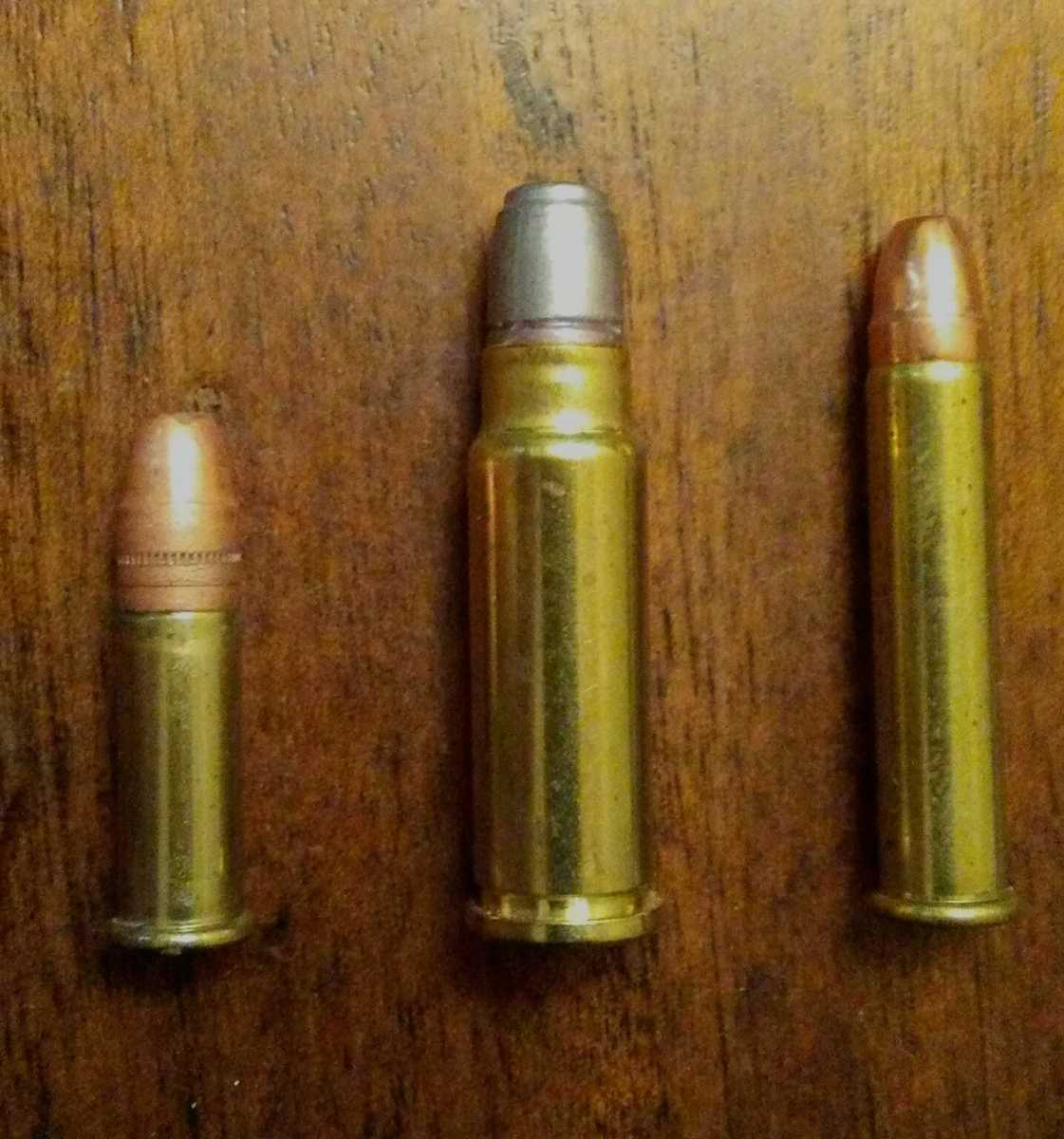

The 250 GNR between the 22 LR and 22 WMR...
![[image]](images/uploaded/201808142250195b735cabd56a6.jpg)

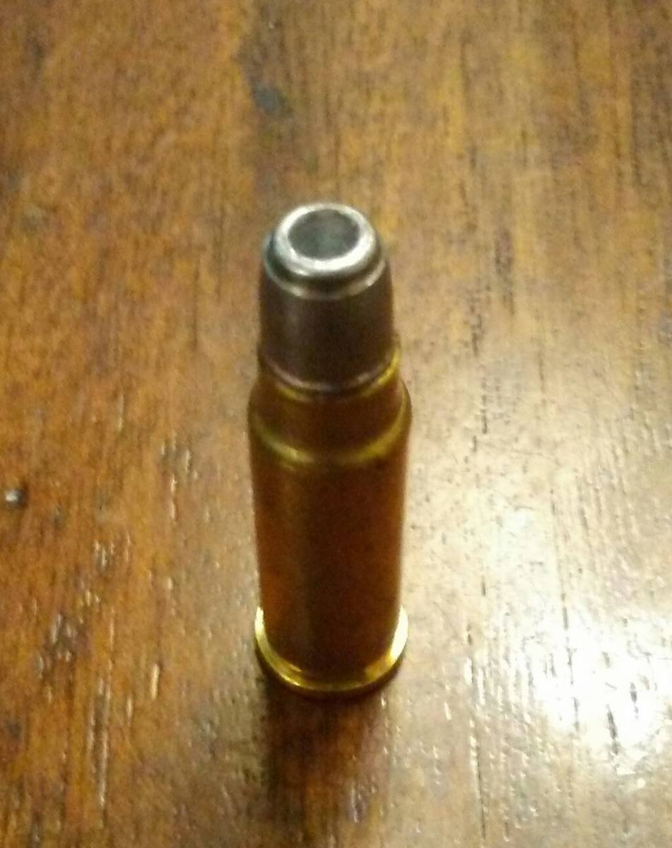

The large Hollow Point of the GT Bullet...
![[image]](images/uploaded/201808142252005b735d104c1b5.jpg)
