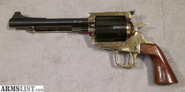

the rim is too wide for a revolver The Century
Sunday, August 26, 2018, 12:52 (3001 days ago) @ Huey
Arms revolver was a monster of a gun, probably weighed in the neighborhood of 7 lbs. A neat showpiece but very inefficient. The 45-70 and 50-70 to be loaded properly have to be loaded with rifle powder and in a revolver, maybe half the powder burns in the barrel, the rest in a bright flash at the muzzle. The cylinder in this gun holds a 45-70.

With some powders it's great...
Huey
Sunday, August 26, 2018, 13:45 (3001 days ago) @ Gary Reeder
But, agree completely with factory stuff. I've found powders like 4759 work great. About the same burning rate as H110 and 4227. Just bulky to fill the case and not position sensitive.
Definitely not the revolver for everyone.
