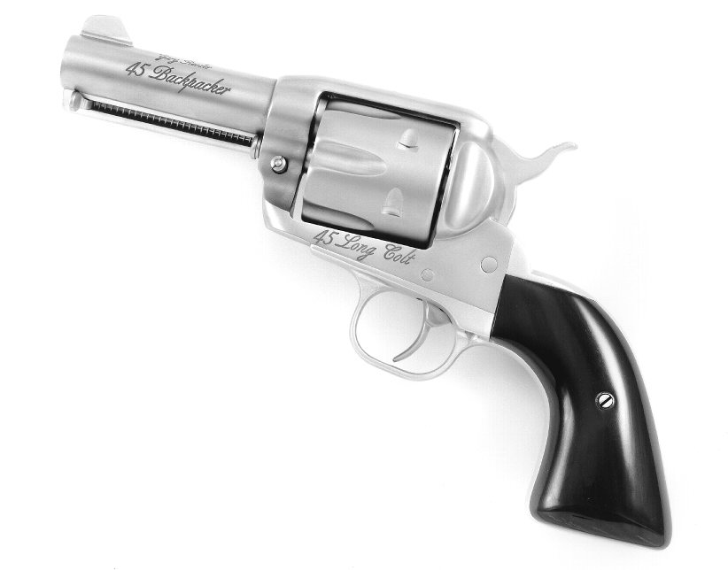

our 45 Backpacker in 45 long Colt weighs in at 28 ozs
Tuesday, September 25, 2018, 11:57 (2971 days ago) @ Huey
We have lightened the hammer, the top of the trigger, scalloped the frame and got it down lighter than most semi autos. And we could have channeled it and got another half oz off that. So why carry a 22 Single Six when you can carry a 45 instead and the 45 be lighter.

stonecold
Tuesday, September 25, 2018, 12:59 (2971 days ago) @ Gary Reeder
That picture is, I believe, of the prototype 45 Backpacker. I got that one from you several years ago and it is my "go to" PPP. I have killed numerous deer and hogs with it. It is nearly always loaded with a 250 gr or so SWC plainbase lead bullet at 800 to 900 feet per second. This load shoots through most things. Since I self limit my shots to 50 yards or less, trajectory is not a problem. It is hard for me to imagine a better revolver or caliber for what I need. This is one of the best revolvers Gary ever came up with (and that is saying a lot).
Yep, stone, that is your gun, the prototype of that series.
Tuesday, September 25, 2018, 13:53 (2971 days ago) @ stonecold
Damn right Gary...another bucket lister for me
