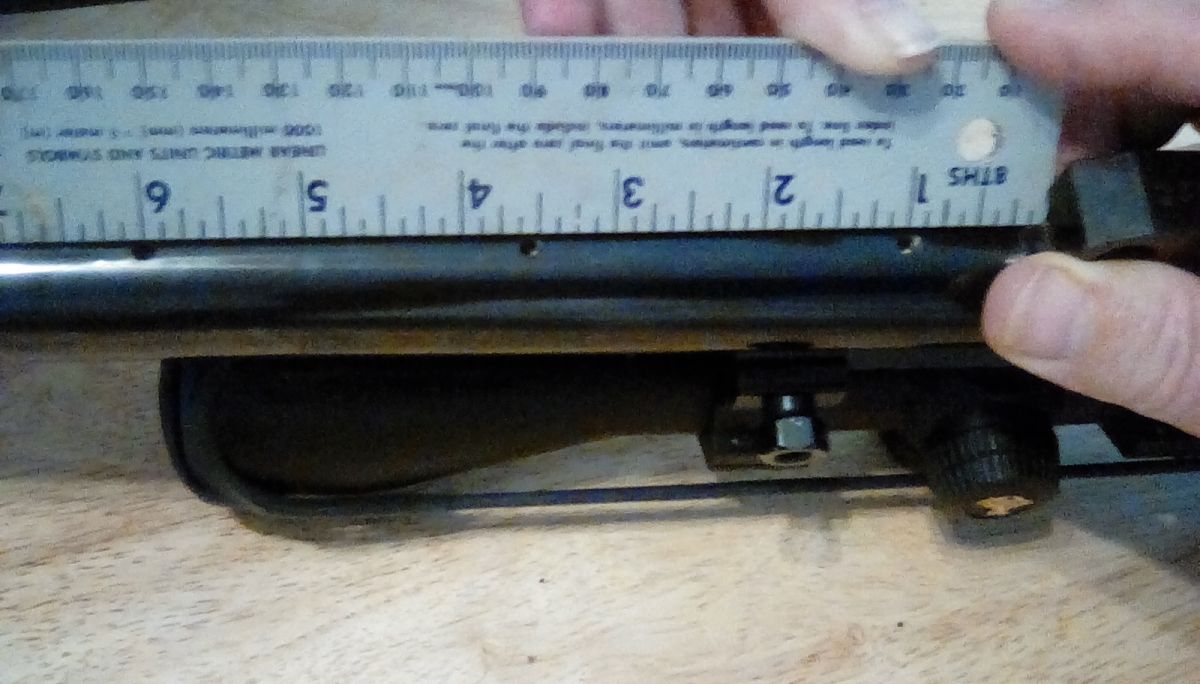

I have 256 Falcon carbine barrel and when I ordered it I did not realize it would have a larger diameter than my pro hunter barrel so I need a forend for it. Do you stock them? Does it require a muzzleloader or shotgun forend?

ifyour barrel is full bull you will need a different
Sunday, October 28, 2018, 14:09 (2938 days ago) @ Grover Sr
forend. I may have one in stock over at our gun shop. Measure the distance between the 2 escutcheons under the barrel and let me know.
Thanks, there are no escutcheons

Three holes staring about one inch from the lug and 2 1/2" apart.[image]
the barrel is set up for both rifle and handgun

forends. The holes 6 inches apart are for a rifle forend while the 2 at 2½" is for a handgun forend.
Ok, from the 1 st to the 3rd is 5" the middle

One is 2 1 /2" from the other two. I will take whatever forend you have in stock that will fit. Colleen has my info.

Sunday, October 28, 2018, 14:48 (2937 days ago) @ Grover Sr
The shotgun forends works. But you need longer screws and washers.

I used a standard pachmayer pistol forend
