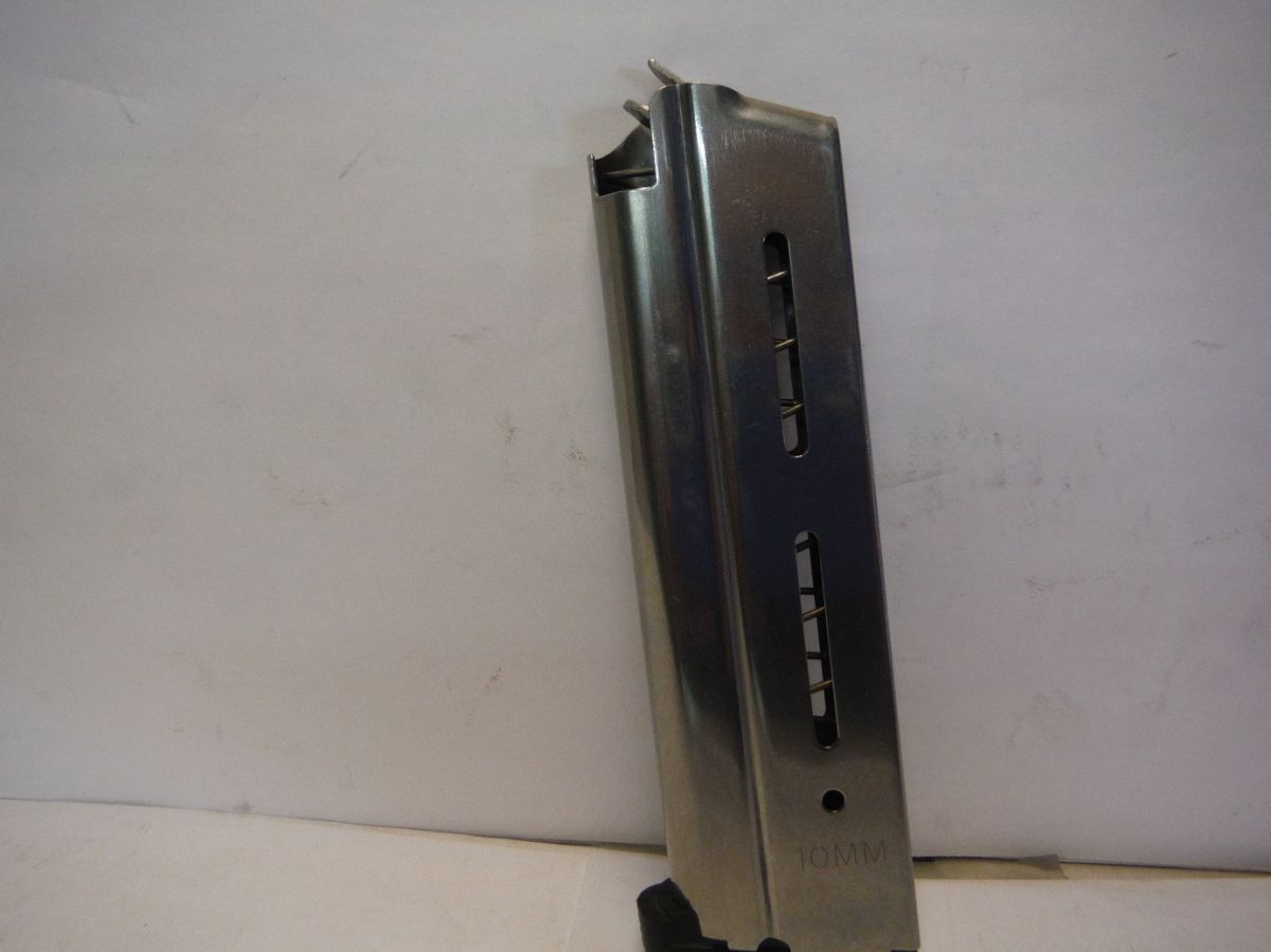

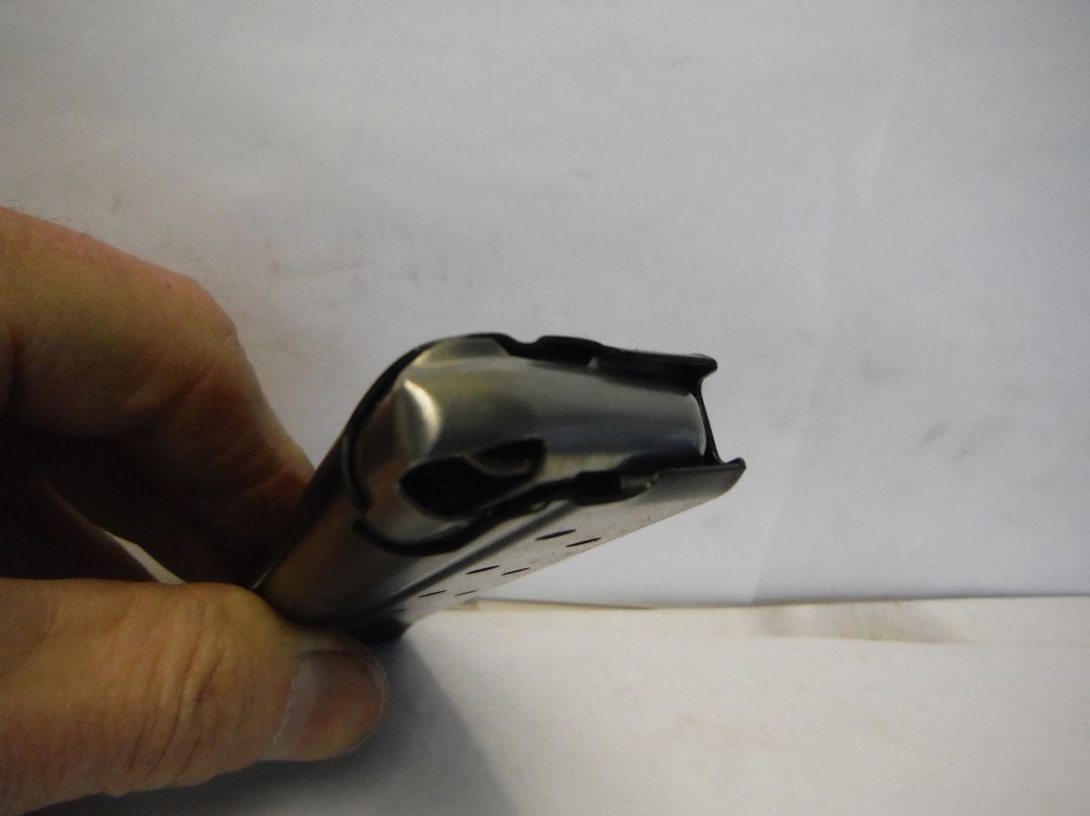

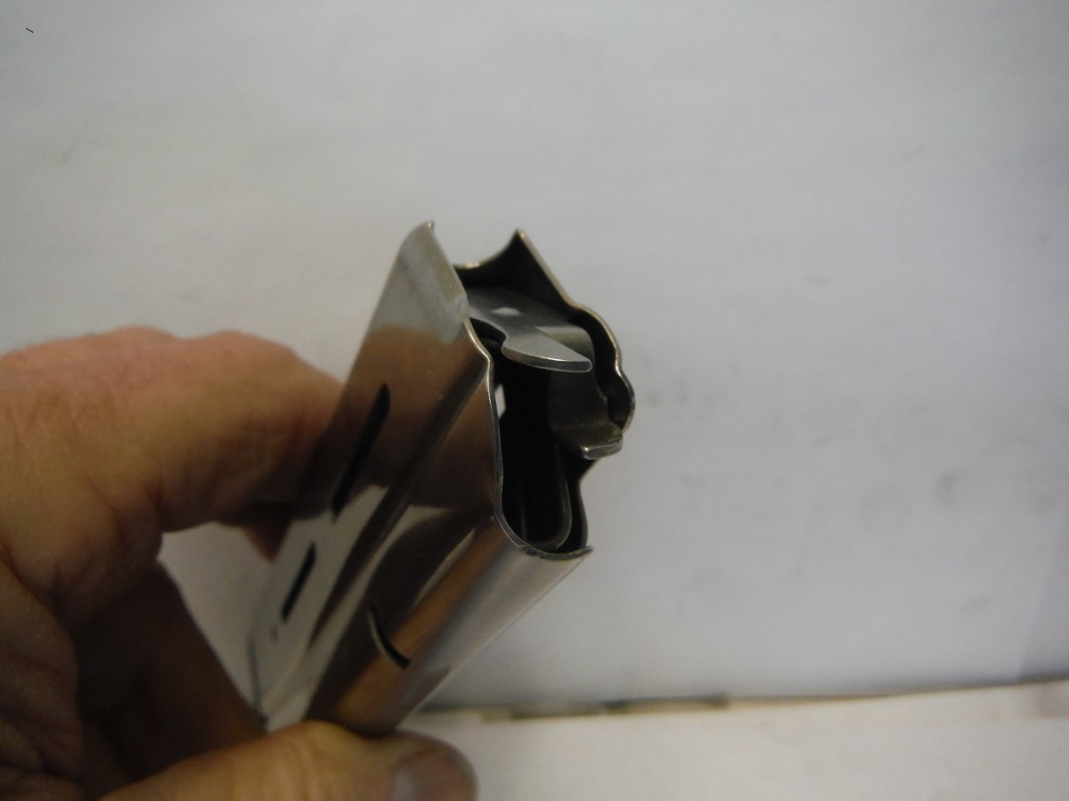

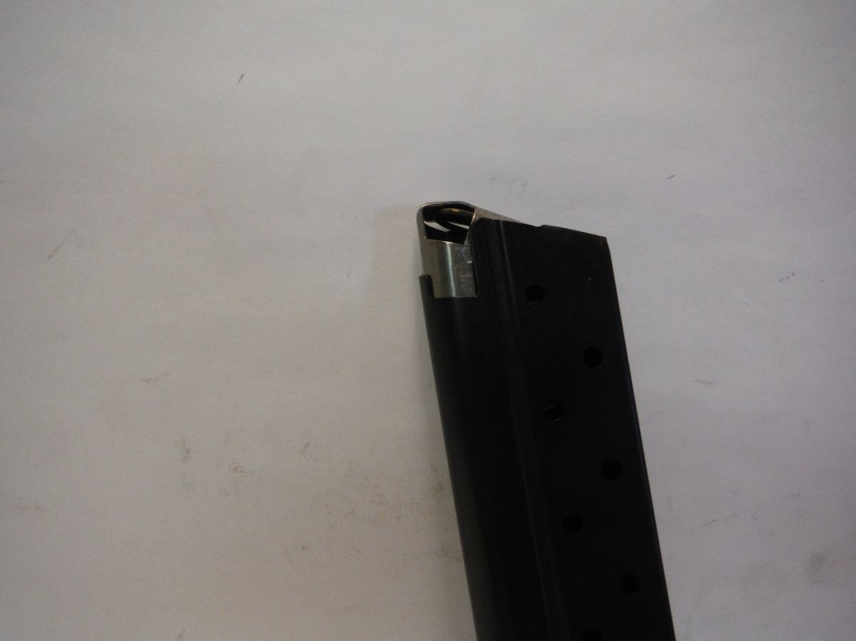

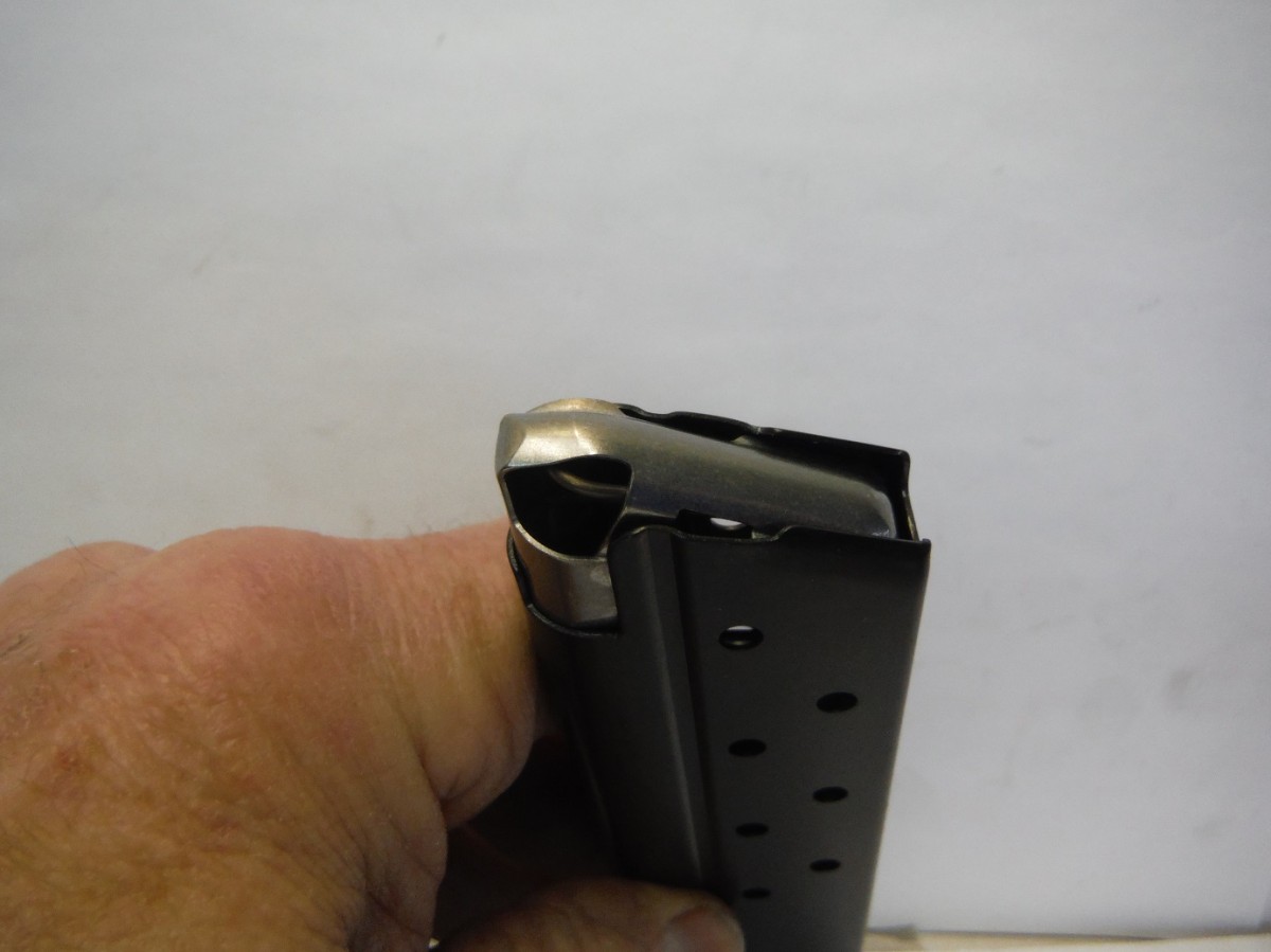

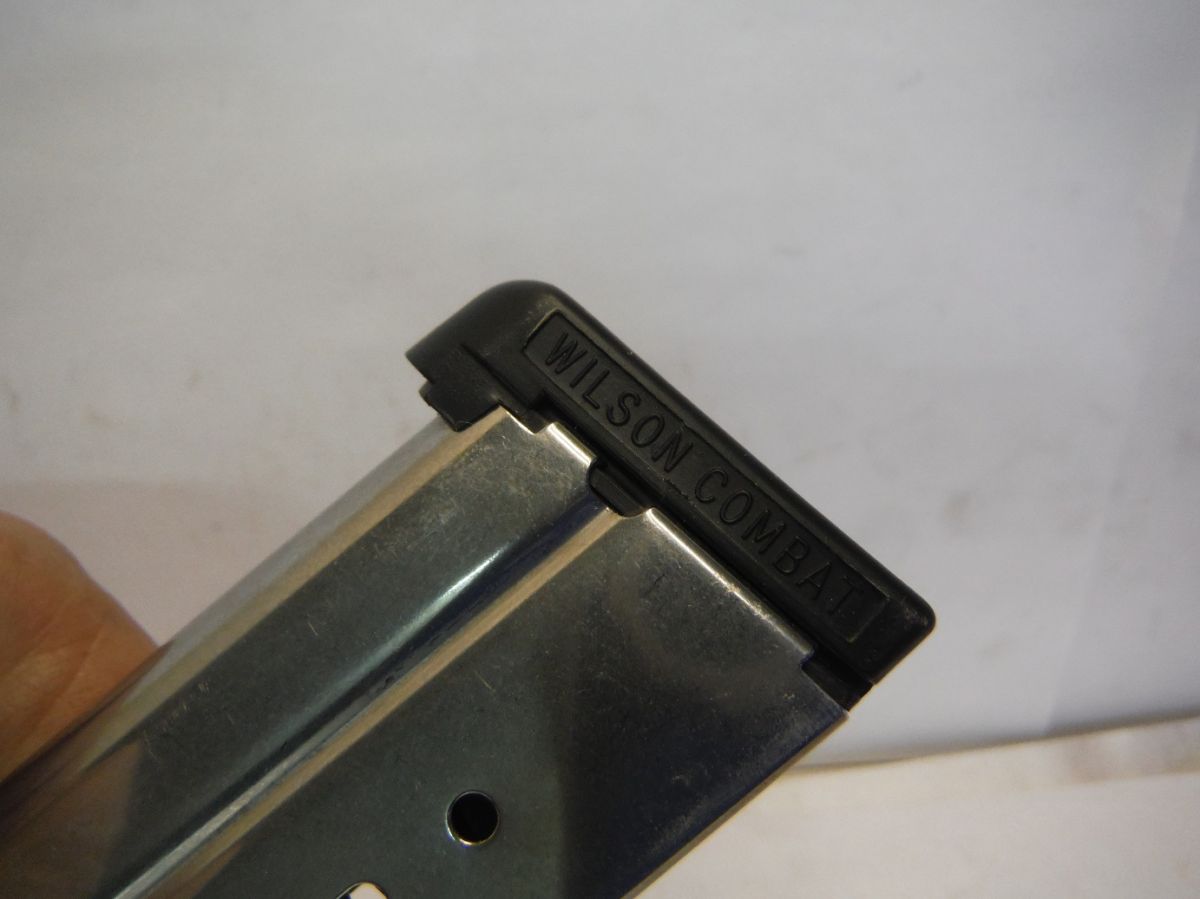

stay away, far away from Wilson Combat magazines. We have had nothing but problems with them. They use a flat follower that jams down in the mag walls causing constant misfeeds, and not just in our custom 10mms but in standard factory 10mms. For their price, they should be perfect. They are far from it. Here is the Wilson mag..

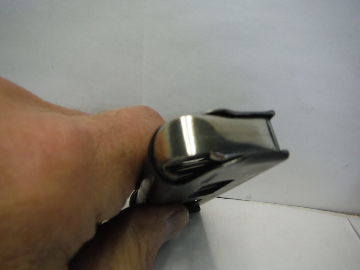

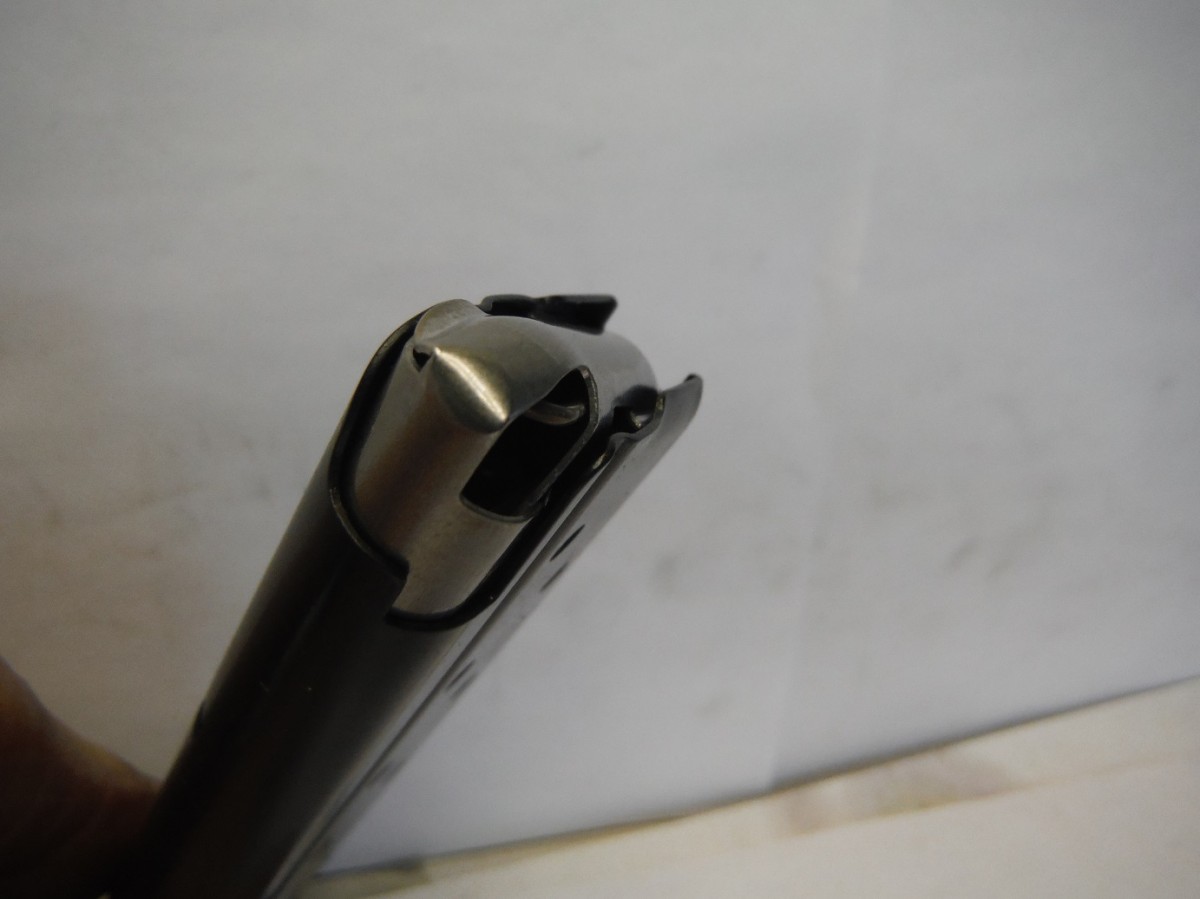

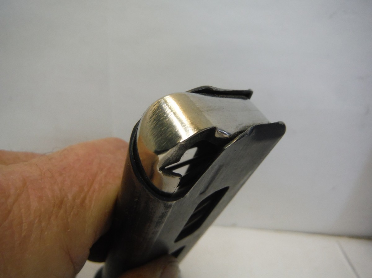

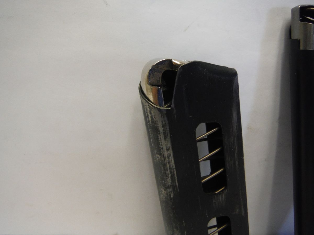

No matter what your semi auto is, try to stay with the magazines that have the rounded follower like this one from Rock Island..

The 38 Super and 10mm autos are really picky about their mags. The 45 not so much. But when buying magazines for your auto, try to stay with mags that have the rounded follower, and stay away from the mags with the flat followers, no matter what the brand is.
