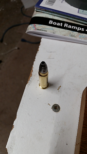

Amede
Thursday, January 24, 2019, 19:19 (2849 days ago) @ Frank Simon
these 130gr LGCHP are showing some promise. And they expand at lower velocities than others.
Pic finally
Amede
Thursday, January 24, 2019, 19:33 (2849 days ago) @ Amede
and another
Amede
Thursday, January 24, 2019, 19:35 (2849 days ago) @ Amede
here are some velocities, and all with a 13" barrel
