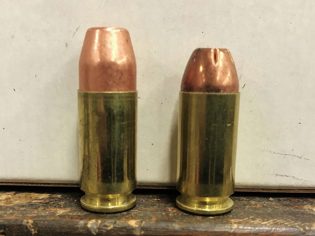

I posted my first test loads. 155 gr. XTP and 180 gr. plated HP, both loaded with 8.5 gr. Longshot with the heavy bullet seated to full 10mm overall length. That loading is a medium .40 S&W loading and a starting 10mm according to Hodgdon's manual.

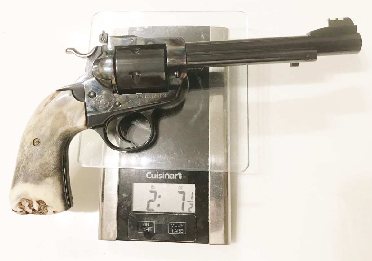

The weight is light and lively and I have to admit I was about 1/2 pound off on my estimate. It's about the same as an OM lightweight .44 Special, 39 oz. Now my example is an all steel Bisley with steel ejector rod housing and heavy stag panels. It would be child's play to build an alloy outfitted Trail gun in 10mm well under 2 lbs.
