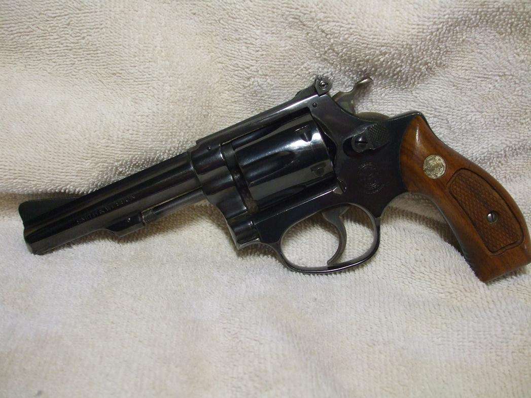

Model 34 shooting it D/A. Clean when I started.

1 round failed in the very 1st 6. Fired on the 2nd strike. Thanks John-I'm thinking now it's the gun.
if it fired on the second hit, in most cases it is either a
Friday, February 01, 2019, 11:44 (2841 days ago) @ ChrisG
high primer in a centerfire or a light hammer spring in a rimfire. Colleen has a model 34 that she hunts with and
the hammer spring got a bit weak a while back and was misfiring and we replaced the hammer spring. Now it is fine. Get your local gunsmith to put a new spring in there and you should be fine. Colleen's M-34.
Can Do! It seems the hammer drops a tad bit
ChrisG
Friday, February 01, 2019, 13:54 (2841 days ago) @ Gary Reeder
lighter in DA than SA. When I first took the grips off of it (last year), it looked like the main spring had rubbed the washers for the factory medallions some? Is that common or even possible? The grips are numbered to the gun so I'd think they'd be fine. Could I be squeezing the grips so hard when shooting it double action that they are contacting the spring? Thanks Gary.
without seeing the gun there is no way to tell, but replace
Friday, February 01, 2019, 15:08 (2841 days ago) @ ChrisG
the hammer spring and that should solve your problem.
As a temp fix
steve todd
Friday, February 01, 2019, 15:48 (2841 days ago) @ Gary Reeder
You can put a spent primer cup between the screw and the spring.
before you replace the spring, take the grips off and
Friday, February 01, 2019, 15:28 (2841 days ago) @ ChrisG
in the lower front of the gripframe there is a small screw. Turn it clockwise (tighten it). If it turns at all that will give a bit more power to the hammer spring and should solve the problem.
