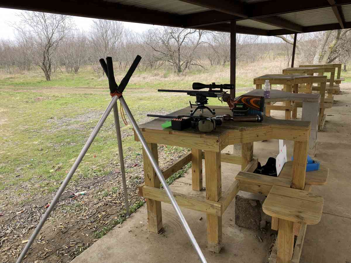

Learned something today. They lash the poles up high for a reason.
That much above the lash point hit the bell objective of the scope. When shooting the -06, I felt like I constantly needed to ensure the rear leg was bashing my scope.
What I learned is to keep a keg to the rear as use that to apply a bit of stability pressure against the forend. Then swing the gun back into the pole then on target. Surprisingly gave me good stability. After relashing the poles with 4” up top, the second gun shot better.

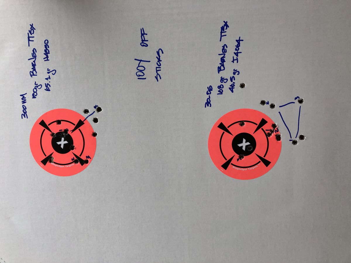

The bad - need more practice. A 3” sticker at 100Y. Oh well, more range days after I replace a scope.

Also dump the Barnes TTSX bullets. Go with a bonded lead core bullet. This is Africa you will be hunting in. The Barnes bullets work sometimes but you want a good bullet that will work all the time and a bonded lead core bullet is the only one that will do that. I have watched guys use fragile hollow point bullets and bullets like the TTSX bullet and wound animals due to the bullet being way too fragile and breaking up on the hide or shoulder bone of an animal. You want something that is tough and break the animal down. Always go for a point of shoulder shot. Forget the old heart shot. That is used only in fairy tales. Aiming for the point of shoulder, if you shoot low you will still break his front leg and probably send splinters into the lungs. If you hit a bit high you hit the spine. Either way is good. And don't worry about a 1" group. You are hunting animals bigger and hardier than a whitetail deer. If you can keep it in 2 to 3" at 100 that is fine.
