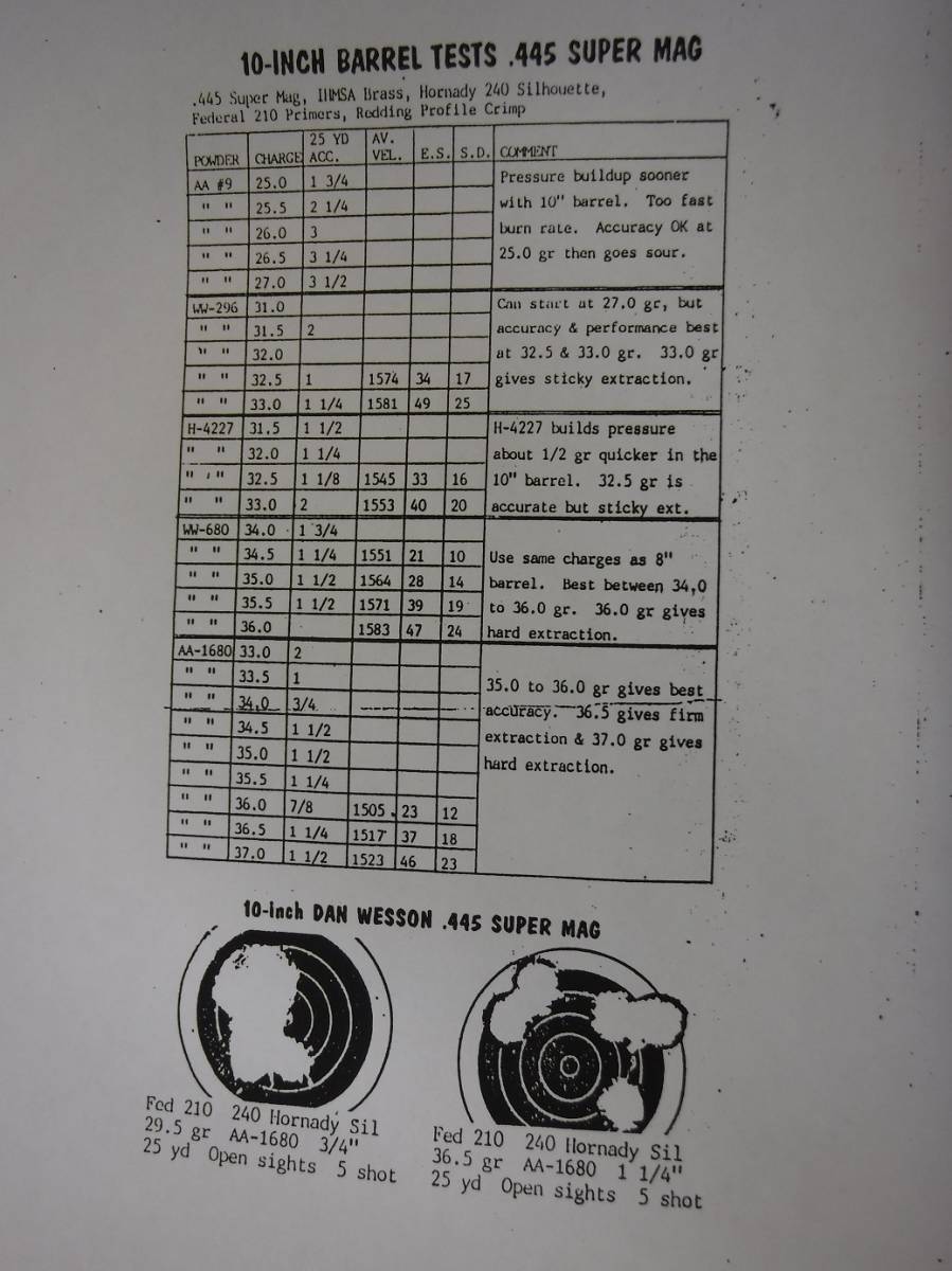

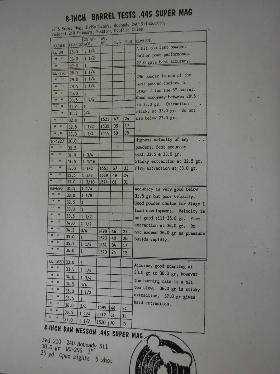

here are the original 445 data sheets for 8" and 10" barrels
- Gary Reeder, 2019-03-18, 14:18
