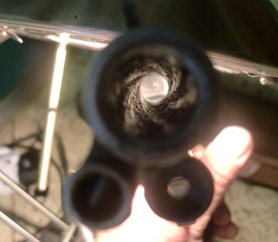

The barrel looks like the inside of an old gas pipe. I figure it must have been used with blackpowder and let rust some. I fired it in the shop a few times and will take it to the range this week and see how it does.

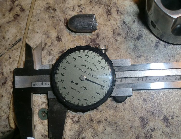

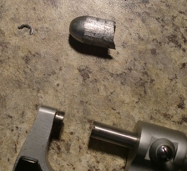

Barrel dimensions are tight ...
Sunday, March 24, 2019, 14:30 (2790 days ago) @ WB
I shoved a .452" ACP bullet through the bore ...
Measures .448"/.449"
Bore is pitted full length on the bottom of the grooves.
.452" bullets drop through the cylinder throats .. It may shoot pretty well once the bore gets a bit greasy. I have shot rough barrels like this in years past and they did ok. We will see.
