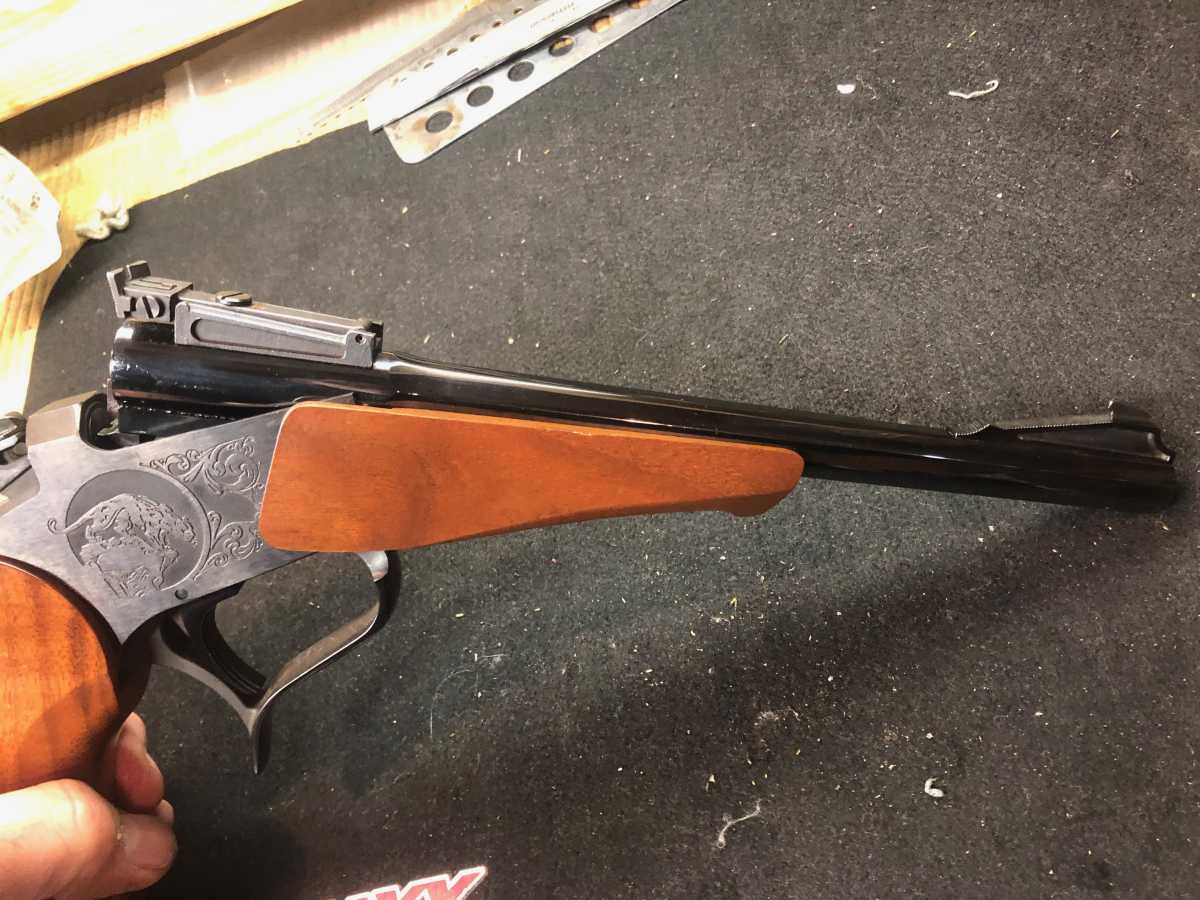

Been researching what caliber to use for Indiana deer. I got a contender at a great price but it has a 222 Remington barrel (not legal). The 350 Legend is coming out but I have been reloading for 40 years and have 445 Super Mag brass and only one firearm chambered in it. So now I would like all the information you fine people can give me on it. Brass , dies and of course ballistics. I normally use a heavy slow combination heavy bullet and low velocity. I read a lot and post very little
