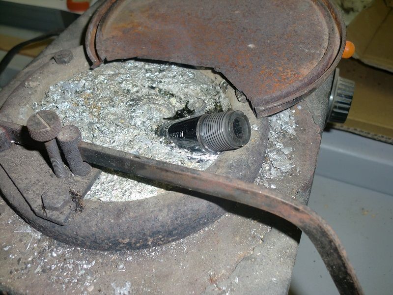

So I drilled a 1/8" hole as deep as I could and then stuck the barrel into the lead pot.

Hammering the heated, melted bullets did not accomplish anything except a burned thumb.

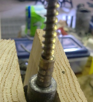

So I stuck the barrel in the vise between a couple oak boards, screwed in a deck screw and using a large nail puller and a big hammer managed to pull the muzzle bullet out.

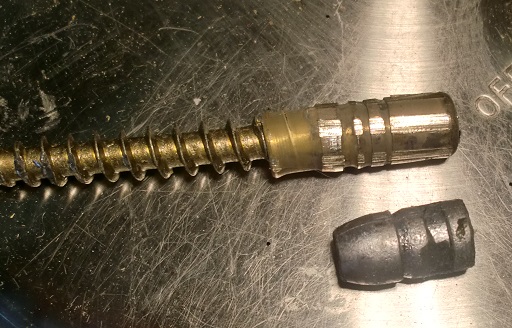

Turned out to be a 200 gr. jacketed rifle bullet. When I drilled the hole I got a huge amount of jacket material out so I figure they were not plated bullets.

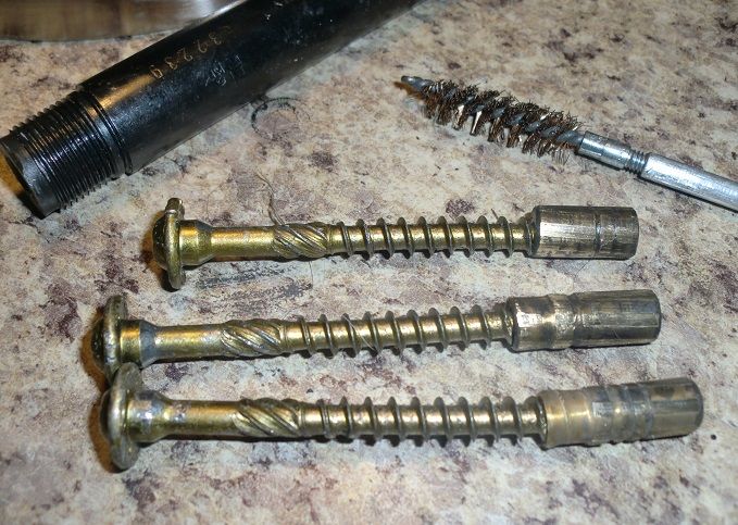

![[image]](images/uploaded/201903251841285c9920d833c1e.jpg)
Turned out to be 2 of the rifle bullets and one apparently 158 gr. pistol bullet.
