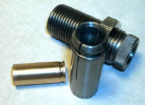

with the 480 Achilles. Had to use the Lee crimp die for the heel bullets.
The cases are short and we needed a spacer to make up for the shortness.
![[image]](images/uploaded/201904072009145caa58eac2af5.jpg)
Kelye at Belt Mountain made us a spacer and modified the Lee 45 70 die ... and it works great. I used it this last week.
![[image]](images/uploaded/201904072010455caa5945ad6c3.jpg)

I am a fan of the collet crimp die for the 32-20. (nm)
- ChrisG, 2019-04-07, 08:28
I wish you could get them for cases under 1.285"...
- Huey, 2019-04-07, 11:42
What about this?
- Rsim, 2019-04-07, 12:45
It's the die that can't be made under 1.285"
- Huey, 2019-04-07, 12:48
Right, shorten the die body? (nm)
- Rsim, 2019-04-07, 12:49

I like it for the .30-30 also. (nm)
- Jim Taylor, 2019-04-07, 09:06
- I USE IT FOR .30-30, .30 CARBINE, .32-20, - JT, 2019-04-07, 11:35
