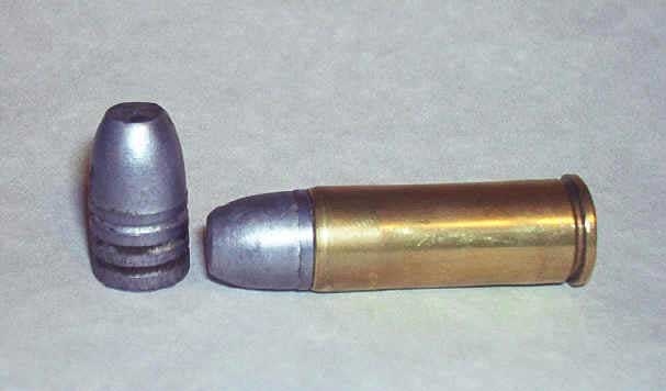

Monday, April 22, 2019, 20:03 (2760 days ago) @ Dave H.
and the 300 gr. bullet that I posted below. They will do anything I want to do with the .45 ...
KEITH 260 #454424; RCBS/SCOVILL #45-270;
Monday, April 22, 2019, 21:54 (2760 days ago) @ Dave H.
NEI 310.451; NEI 325.454; AND THE ORIGINAL HW WE USED JIM'S FAVORITE 300 GRAINER DESIGNED FOR THE .45-70.
