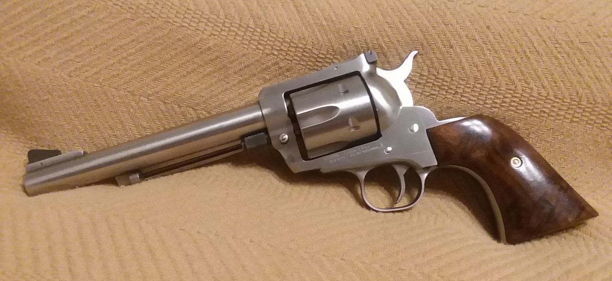

Decided to try one of these a few months ago. Schedule has slowed progress, but finally getting there. Slicked up the action, installed Wolf Springs, Belt Mountain Base Pin and some nice Claro Walnut grips. Long seating of bullets allow 180s/1400+ fps and 200s/1300 fps. Groups 1-2" in informal chronographing sessions...
![[image]](images/uploaded/201905070040365cd0d404803b2.jpg)

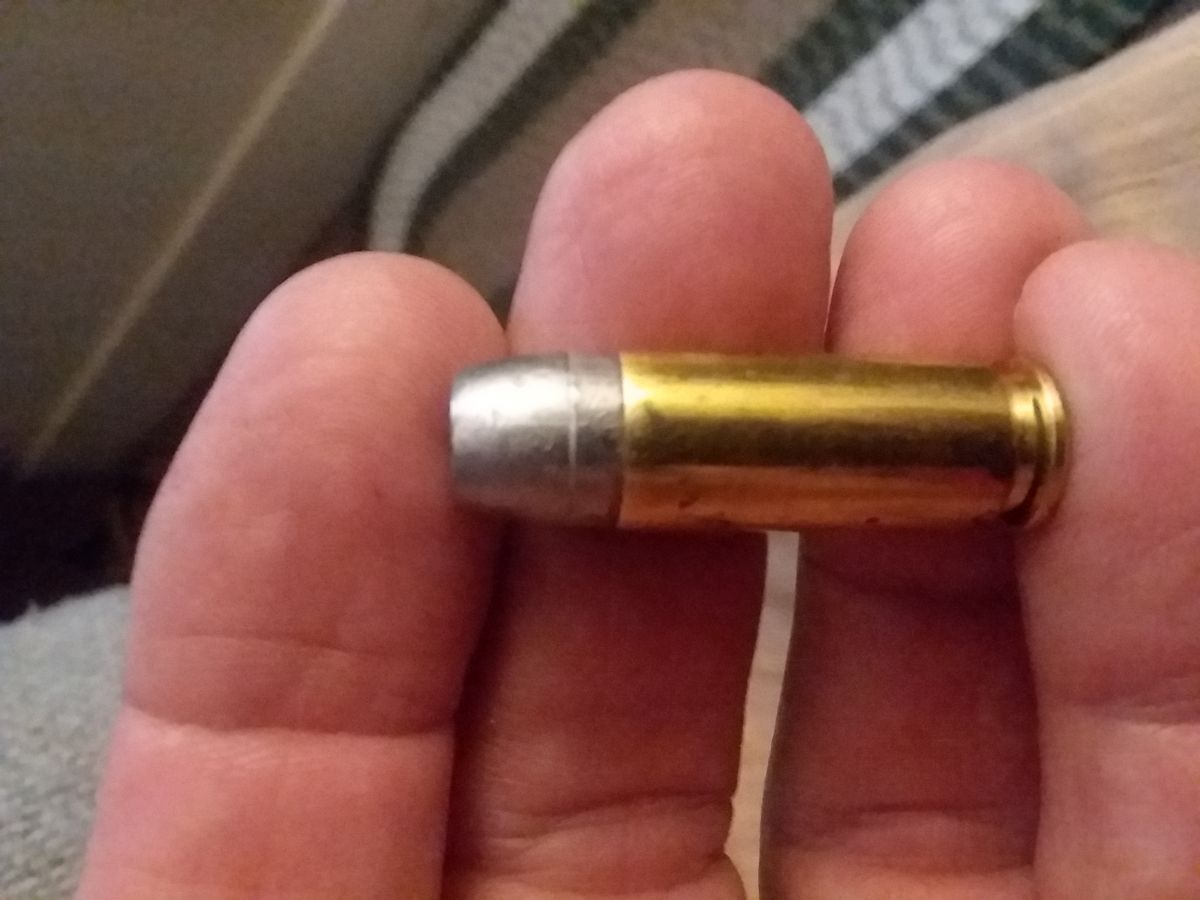

The 200 grn GT Hollow Point Long Seated in the 10mm Case...
![[image]](images/uploaded/201905070043165cd0d4a4c69a5.jpg)
Ruger 10mm-40 S&W Blackhawk...
