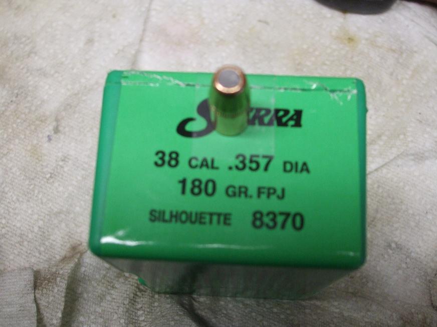

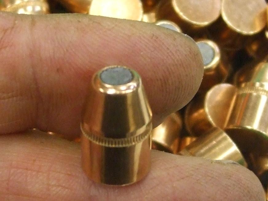

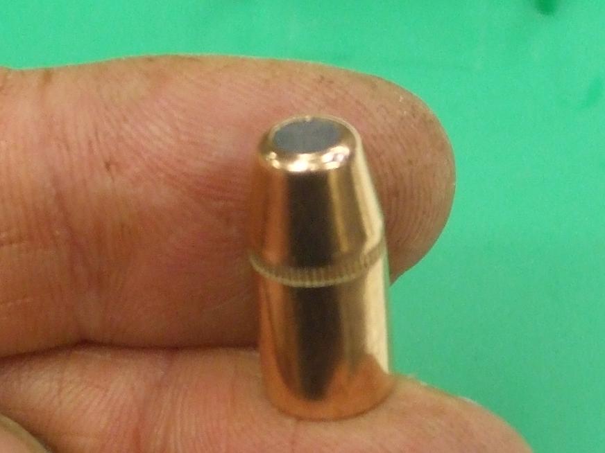

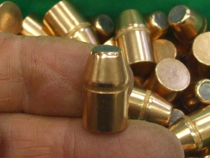

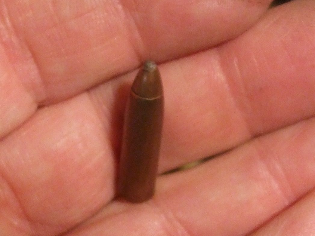

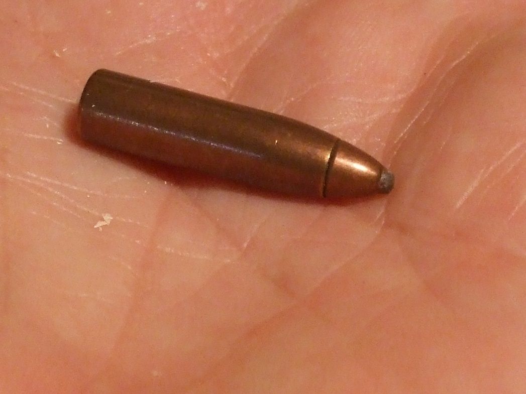

Speaking of "hard" bullets and game performance. These are not full-patch bullets but actually jacketed bullets with a "hard" point rather than a "soft". They sport a reasonable meplat and will shoot through about anything. I have seen them sort of mash into a totally flat nose, after penetrating heavy bone, but never actually expand or lose any weight at all. Most sail on through never to be recovered.
Gary has really amazed me with their performance on game. I've seen him do it several times but I'm not sure I can place the bullet so well. I keep trying, practicing.

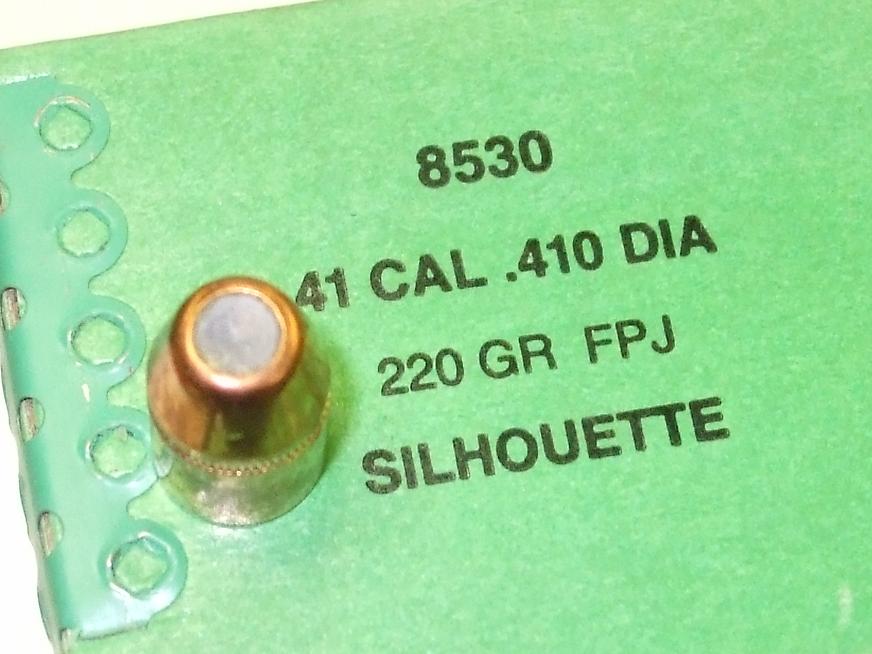

"Sierra .41 Magnum Caliber 220 Grain FPJ Silhouette Bullets"

has taken probably 2 dozen big critters like that. Usually one shot if I do my part. After seeing the failure of 45 ACP JHP bullets on Colleen's bear I have decided no more JHPs. The 41 caliber silhouette bullet is, as you said, almost a FMJ with a tiny bit of lead exposed at the tip and they act like a FMJ.
The silhouette bullet is perfect for large animals like Bull Elk, Bison or any other large bodied animal. But they aren't worth diddly on small animals like hogs or deer. They punch right thru like an ice pick and they run off wounded. For them stay with a good soft point bullet.
I think Remington was the first to come out with a solid tip hunting bullet. It has a separate brass tip that forced the bullet to expand on impact yet it went deep into the animal.
