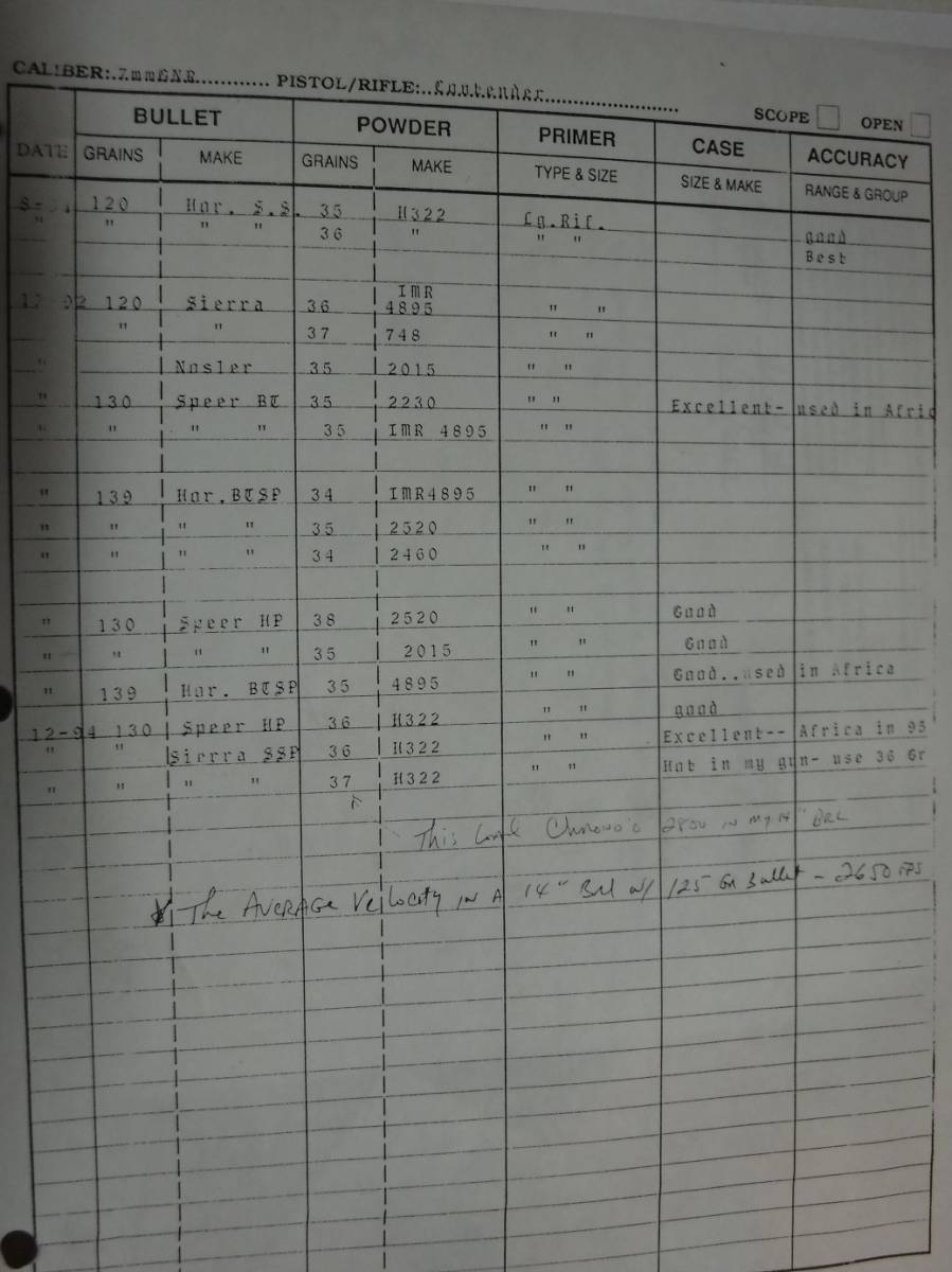

when we first developed the 7 GNR there wasn't a
Monday, July 15, 2019, 16:46 (2676 days ago) @ Gus S.
large group of bullets that were suitable for it so we had to use what we could. Here is my original load data sheet for you. This showed data from '88 thru '94.
