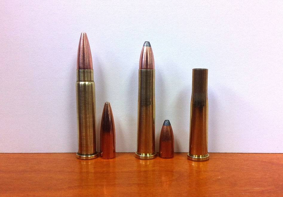

Photo shows the steps of making a .240 Banshee from .22 Hornet.
