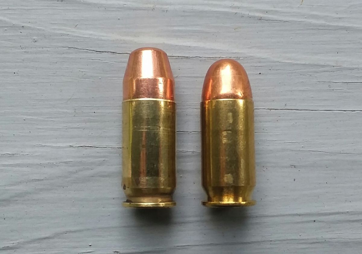

The normal length of a loaded 45 ACP is around 1.250" I believe. I loaded mine to 1.355". Now I realize that 1/10th of an inch isn't much. But, it makes a huge difference in the pressure curve.

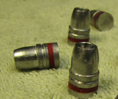

These are the bullets...
Huey
Sunday, August 25, 2019, 17:17 (2635 days ago) @ Huey
They seat shallow and are ideal for this chamber. Will size some .451" and get them loaded.

The 460 Rowland is more of a loading change than a cartridge
Huey
Monday, August 26, 2019, 04:09 (2635 days ago) @ Gary Reeder
In the TC. I have 460 Rowland setups in both 1911 and Glock configurations.
But, in the TC there are zero differences except loading.
While some whine about cases strength, that is more to avoid blowouts due to the design of the auto loading weapons. In the TC's chamber, the issue disappears.
Being able to seat bullets out gives the advantage here. Both in performance and preventing ammo from entering the wrong guns.

What I was saying and, I think what Gary was saying, is there is no advantage to using the 460 Rowland chamber or brass in the Contender.
The longer Rowland case prevents it from entering the 45 ACP chamber. It does not increase powder capacity due to COAL being the same.
