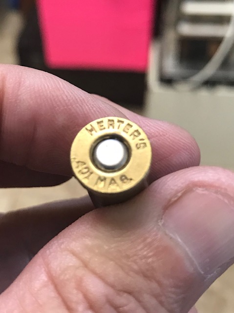

Norma in Sweden to manufacture ammo and components. It is top quality stuff and still a great find some 50 yrs. later. .30-30 brass can be cut down and the rims spun down to work. I use .41 Mag. brass by sticking it on a mandrel I made to clamp them in my lathe to turn the case head down about 0.009". Sizing a .41 in a .40 S&W die throws up that teeny belt that has to be trimmed off to fit. Also the OAL of brass is 0.125", not the resulting 0.127-0.131" the .41 ends up being.

![[image]](images/uploaded/201908281403485d6689c446eb1.jpg)
