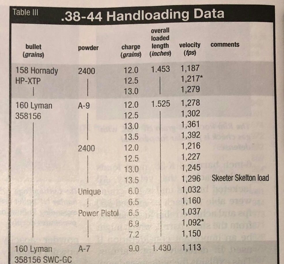

Economical 9mm will be fun to plink with. The 38-44 HD will come dangerously close to 357 Magnum. In reality, just the 38 Special loaded to 35,000 psi.
Had a number of folks ask me about the 38-44...
Huey
Thursday, September 05, 2019, 04:58 (2625 days ago) @ Huey
Nothing more than a 38 Special loaded to pressures higher than normal. I'll have to turn rims down a bit on the TG due to loading gate restrictions. Very simple job and 100 cases will last a long time.
The original 38-44 Load by Keith used a long nosed 173 grn (I think) bullet. My loads will be limited to 1.5" OAL. Again, this will be no issue.
