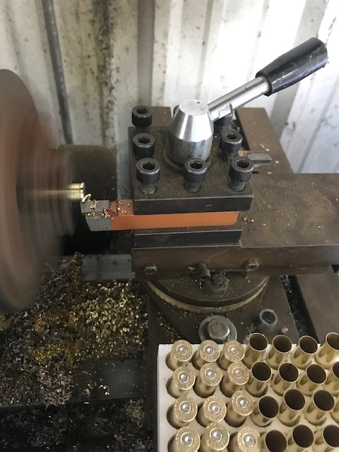

I figured I needed to recheck it. I had fitted it to MY gun and decided to bring it to minimum specs so no problems. My gun can handle rim diameters as large as 0.483" but factory brass was 0.477, so that is what I did. The Herter's has countersunk chambers enclosing all the case head, a throw back to balloon head brass and separations. I don't like them.
![[image]](images/uploaded/201909062121505d72cdee952b8.jpg)

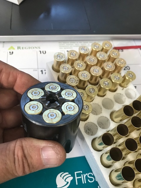

0.006" is not much until it won't fit.

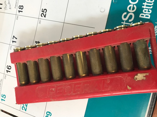

I think it will work, from .41 Remington Starline.

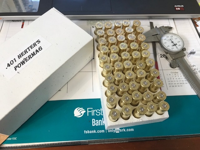

Now on to revisit making them from .30-30 Win. Already turned rims. 30-30 brass is awfully thick though and wildly tapered.
