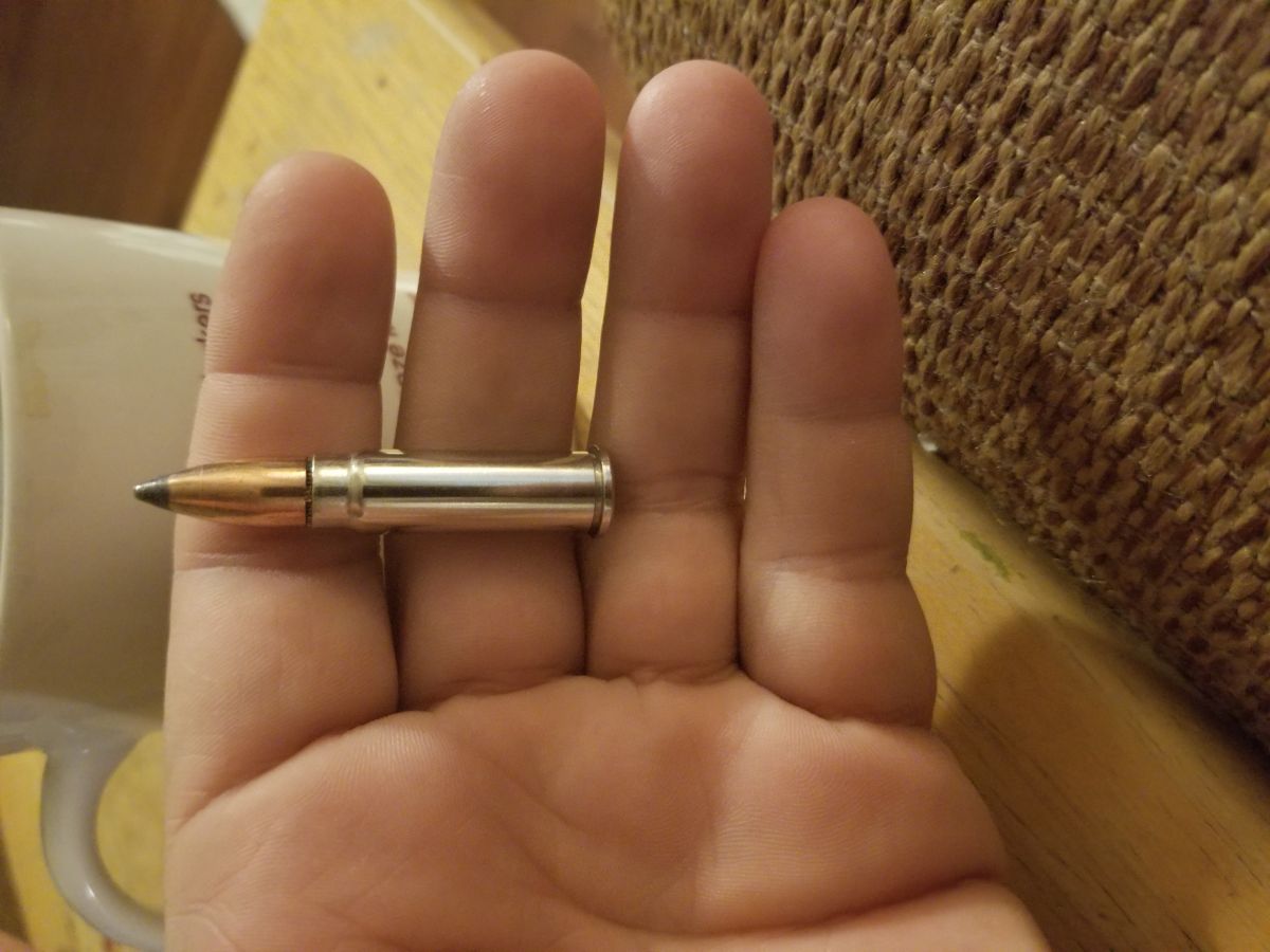

I'm kinda tickled about the 321
Gus S.
Saturday, September 07, 2019, 06:12 (2623 days ago)
Going to start with the 125s over H110.
Neat looking little cartridge with the pointy bullets, too.
Its a fun little cartridge with lots of potential.
