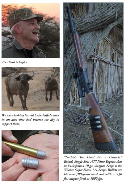

Misfits are everywhere, just keep you eyes open. Hey, of all people, I'm not going to poke gun at a man chasing his dreams. I was taken aback initially when I spied a $300-400 set of wood on what looked like a $150 NEF shotgun in an African hunting camp. He has some fancy stock under tang stuff going on that I have not figured out yet, very interesting. Looks like a brass extension receiver and tang added to support the wood. Factory kit is a simple mortise and skinny bolt.
This fellow (a Canadian) built himself a .577 Nitro Express on an old 10 ga. NEF or H&R chassis. I have had and shot several myself. They generally weigh about 7-8 lbs. but sport a 3 lb. bar of steel concealed under the factory rubber pad. This feature balances the "Goose Gun" nicely. In 3.5" 10 ga. using the 2-1/4 oz. loads they are devastating tools. They outpace, in my experience, all 3.5" 12 guns except the Mossberg which has a backbored special barrel. But then again, unless you like loosened teeth, stay clear from the 8 lb. Mossberg Turkey gun and those hot loads.
