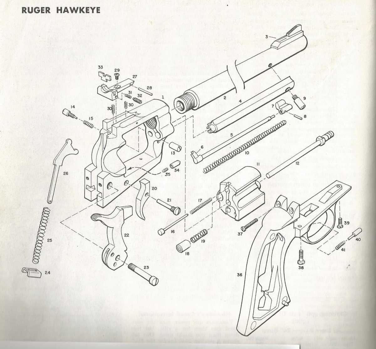

What were the Ruger guys were smoking to come up with the Hawkeye? At first it just looks like a Blackhawk with a funky cylinder block. But looking closer I see only two "screws" in the frame. The exploded diagram shows the changes in design and simplicity. The pic does not show the barrel chamber rim recess nor milled extractor groove. They just used a standard barrel pic? The firing pin seems to be a rebound type as there is no provision for a safety nor partial cock to keep the hammer away from the firing pin.
