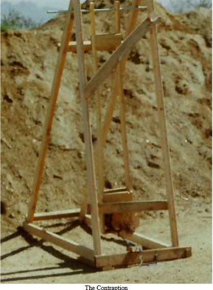

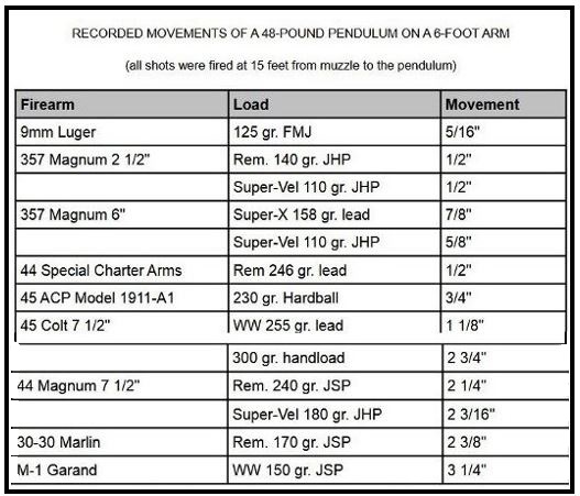

I once hung a 48 pound Mesquite log on a 6 foot arm and measured how hard various guns and loads hit it.
![[image]](images/uploaded/201910091427555d9dee6bcd720.jpg)
I fired into it from 15 feet.
![[image]](images/uploaded/201910091428235d9dee87b8d96.jpg)
A 300 Winchester Magnum had about as much hitting power as a 24 oz. claw hammer swung as hard as you could.

Facinating test you did, I can relate
- WB, 2019-10-09, 08:04
- This was basically measuriing "momentum" - Jim Taylor, 2019-10-09, 08:08
