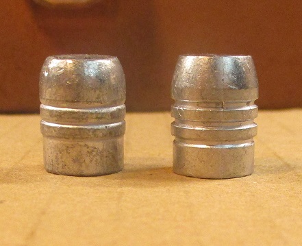

Bullet selection for the 480 Achilles has been limited. Two bullets! The original Bittner design or the Huffaker bullet that is a copy of the .476 Ely bullet.
Yesterday my friend John Killebrew sent me about 12 or 15 pounds of the bullet he designed. It is an improvement of the original bullet. The original had small grease grooves making the use of Lee Liquid Alox a "must". John designed the bullet with deeper grease grooves. He added a crimp groove in the heel, which is a real plus. Crimping is VERY critical with heel bullets. And he reduced the size of the meplat and made the nose more rounded. I can't wait to try some out. I think this may be the premier hunting bullet for the Achilles!
![[image]](images/uploaded/201912211516585dfe376a1a747.jpg)
LEFT - the original bullet RIGHT - the Killebrew bullet .. Both weigh right at 290 grains.
A New Bullet For the 480 Achilles
