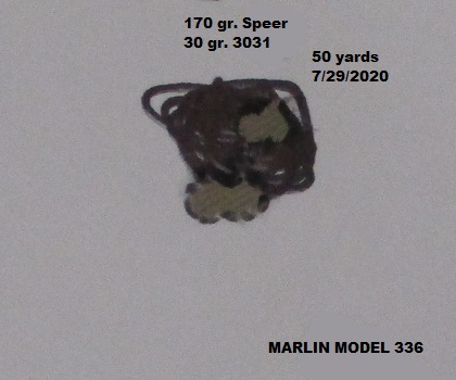

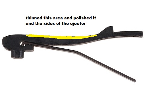

Spent time on the 50 yard line this morning. The rifle is working good. I got to looking at the ejector and figured if I gave it a little more travel and increased the spring tension it would help the ejection.
![[image]](images/uploaded/202007291813465f21bc5a3aba8.jpg)
I did the "cut and try" method, not wanting to take too much off, and after a number of tries it is working just fine.

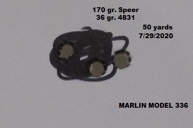

I shot mainly the Speer 170 gr. bullet with a couple different powder charges.

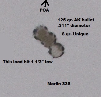

And I tried the AK47 bullet ...
![[image]](images/uploaded/202007291816425f21bd0a73880.jpg)
The gun ran fine .. no issues. I think I will need to take this one hunting.

Sorry ... was not a cast bullet ..
- Jim Taylor, 2020-07-29, 13:02
Oh, my bad. I bet a cast with same charge would do well.
- WB, 2020-07-29, 13:13
They are sized by the time they move .100" ...
- Jim Taylor, 2020-07-29, 13:23
I find that often true .308 vs .311 bullets
