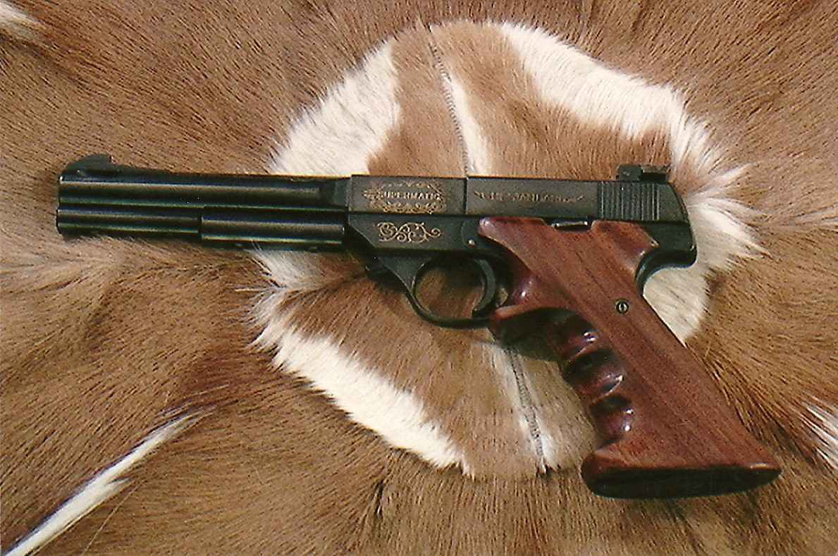

he used in the military shoots and shot several records with it. He offered it to me when he was coming down with Alzheimers but I passed on it. It shot a very special 38 caliber cartridge, somewhat similar to the 38 wadcutter. He gave me his High Standard that he set a lot of records with, some of which still stand.
![[image]](images/uploaded/202009021914275f4fef1356d06.jpg)
At the time High Standard was the distributor for the 44 Auto Mags and he gave me his Auto Mag that was his display piece. I felt bad taking those guns but I knew he had a good reason for giving them to me. The 38 AMU didn't interest me but I should have taken it. The AMU stood for Army Markmanship Unit. And there were very few of them made by Colt.
