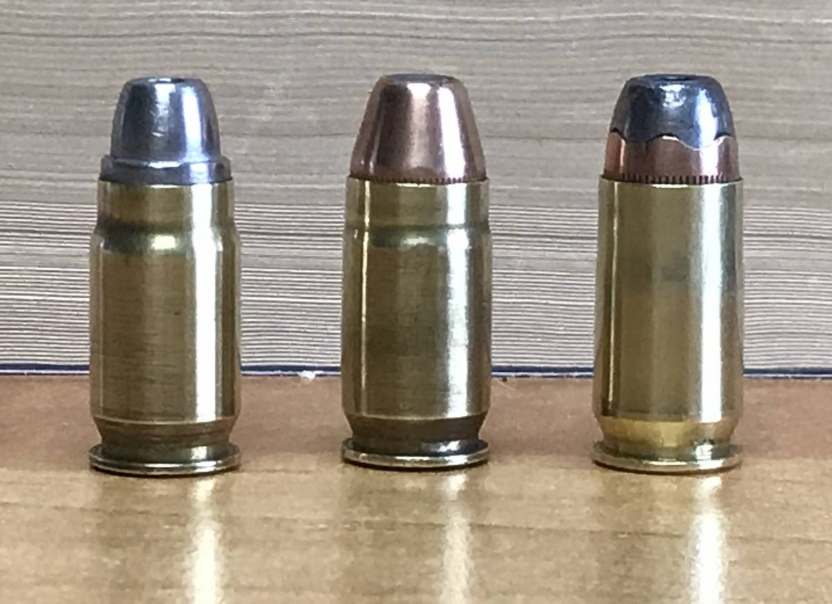

.400 Corbon, 44/Corbin, tapered .44 ACP
![[image]](images/uploaded/202009030106235f50418f6c1e7.jpg)
I was wanting to play with brass today if I can sneak away

- Neck down some 460Rowland? May give a bit more brass length. (nm) - Drdougrx, 2020-09-02, 11:52
Can not find anything, other than the idea has been
- Asa, 2020-09-02, 11:22
- The charm of the exercise is to mimic the .45 but with a .44 - WB, 2020-09-02, 11:31
- Why not try necking up a 400 corbon? (nm) - Amede, 2020-09-02, 10:56
Concept pic

I tried it years ago and never had any luck. When
- Gary Reeder, 2020-09-02, 10:28
I forget what it's called exactly but there is
- WB, 2020-09-02, 10:42
- an old fellow in Florida I used to know did - Gary Reeder, 2020-09-02, 11:38

38-55 Clerke
- Asa, 2020-09-02, 11:14
I believe that was originally for Bullseye competition
- WB, 2020-09-02, 11:25
Colt made a run of 38 AMU 1911s. Joe Benner had one that
- Gary Reeder, 2020-09-02, 12:17
here is the 38 AMU pistol and the ammo
- Gary Reeder, 2020-09-02, 12:29
I have run across some empties in the past but
- WB, 2020-09-02, 12:36
In case you missed the pic on the post above
- WB, 2020-09-02, 18:06

got it. The 400 Cor Bon necked up is the sensible way of
- gary reeder, 2020-09-02, 22:23
I have also come to that conclusion.
- WB, 2020-09-03, 07:21
- I agree except for the minimal neck. That has never - Gary Reeder, 2020-09-03, 16:17
