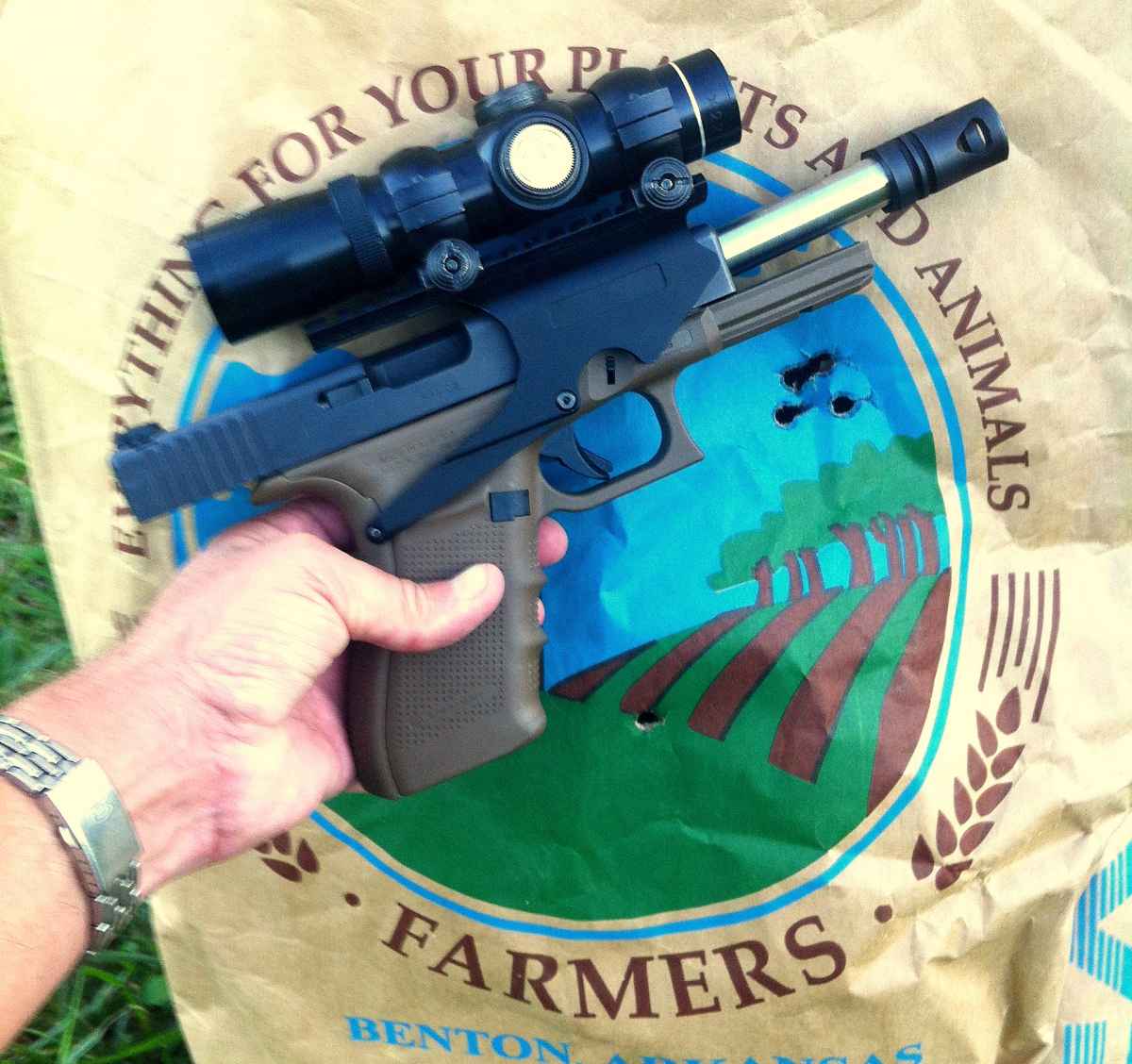

I installed a inexpensive Wolf barrel that I modified the chamber and lengthened the throat. Actually too much, I could chamber 300 gr. WFNGC bullets with room to spare. But it is fantastically accurate, far beyond what I can hold. I wrestle with sights and that trigger but it has mechanical accuracy in spades.
This is a sighter and (4) shots at 33 yds. The load was a 200 gr. at 1400+ fps and the mount was hitting the slide in recoil, frame flex! That didn't work long. OK for a 9mm but my antics were too much.
![[image]](images/uploaded/202009061845205f552e401a27e.jpg)
