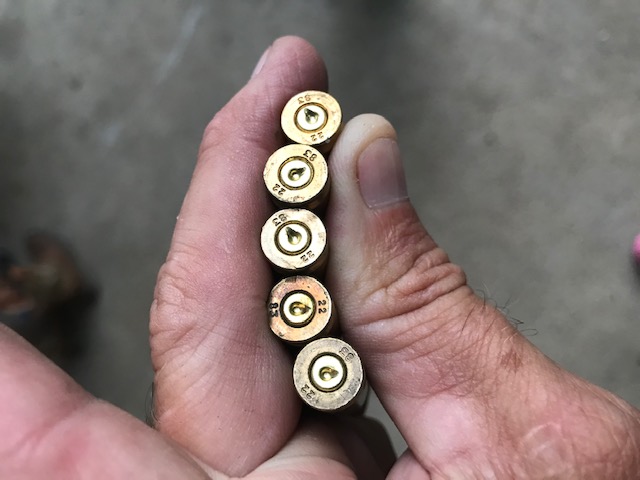

I've admired these for a while and have fired the Chinese Version 7.62X25 Tokarev. This is a Serbian M57 which differs in a longer gripframe and magazine. It holds 9 in the mag. There are some goofy features such as a mag disconnect and added thumb safety, kind of like a 1911. You can carry it cocked and locked. This example malfunctioned with the original full guide rod and a Tokarev plug and short guide has been installed. I think it needs a new firing pin spring looking at the primers of fired cases. It's still protruding after firing, telltale slightly marking the primers.

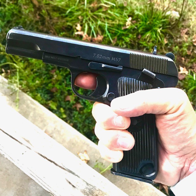

It's natural to compare it to a 1911 actually. The top half is very close in design but the bottom and fire control is vastly different. It's sort of unitized. The trigger is mushy and about 10 lbs. You're not going to accidentally pull the trigger. It does show some good build quality. The teeny dovetail drift front sight is nice. The barrel is close to 4-1/2" and it's an inch shorter than a Govt. model 1911 and only about 3/4 as wide, it's thin. The grip angle is less rakish and it feels interesting.
