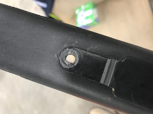

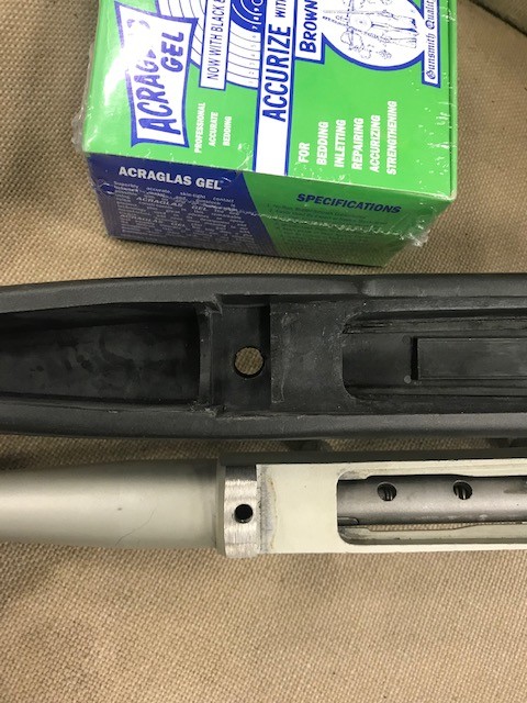

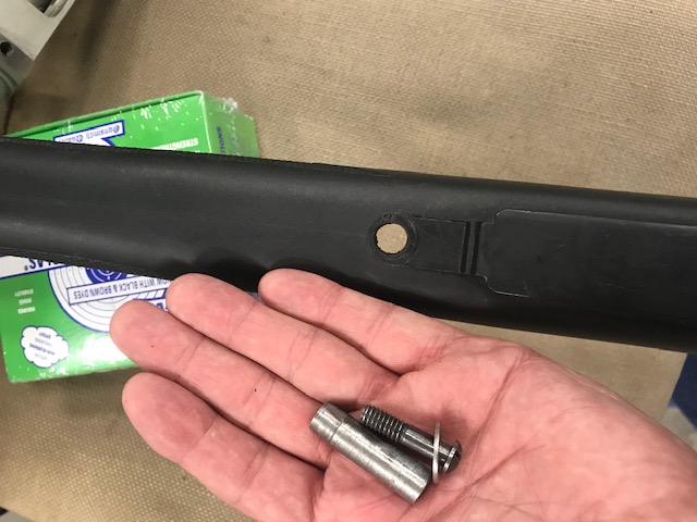

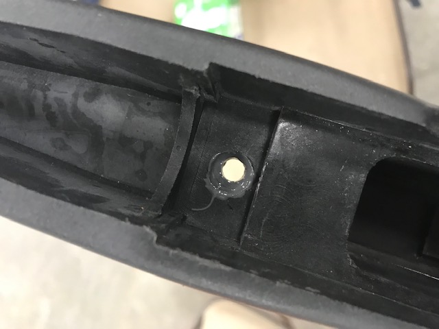

I have a project I'm working on myself. A "Raptor" brand .270 bolt rifle. The front action screw pulled through the stock. I had to "cold tack" the bushing I made with JB Weld. The action screw hole is off center so I have to "set" this in place then tomorrow glass bed the lug where it won't be moving or flex the action. I'm doing this in a manner where it drops in only one way and no stresses. A friend gave me this gun and if I can get it to shoot under 2" at 100 for a loaner or truck gun what fun! Raptor design was bought by Mossberg and is now their bolt gun line.
![[image]](images/uploaded/202011200019325fb70b94324e1.jpg)
I had to re-drill the hole in this bushing and cut it to fit.

Tomorrow I'll fill this area with glass compound.

This is a multiple session job. Then on to feeding issues with basically a faux blind magazine. It's one of the worst stocks I've seen.
