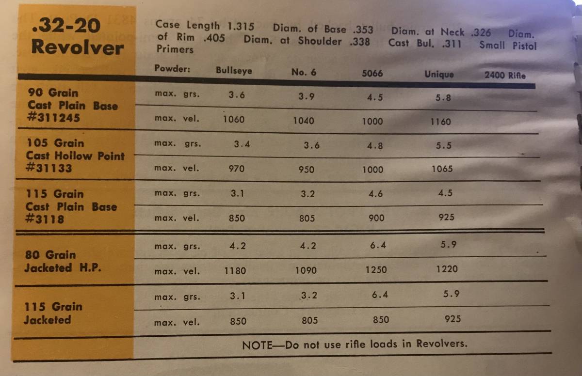

From the 1960 Lyman #42 Manual. The power levels were the range I was searching for. Testing to obtain shooting to fixed sight elevation will begin soon. I’m not keen sawing on this rig’s sight. FWIW.
![[image]](images/uploaded/202101050622275ff405a3d0237.jpg)
I got some credible .32-20 revolver data

Brian Pearce had a nice 32-20 article for
- ChrisG, 2021-01-05, 05:23
Thanks, I think I have that someplace. (nm)
- WB, 2021-01-05, 05:36
Handloader 290... (nm)
- Huey, 2021-01-05, 05:42
Thanks Huey, a great help. I'm hoping to
- WB, 2021-01-05, 07:55
I found blackpowder to work really well in the 32-20
- Jim Taylor, 2021-01-05, 08:49

I use 5.5 grns Unique behind a 100 grn SWC...
- Huey, 2021-01-05, 05:23
That's been my 'standard' load behind
- Russell Cottle, 2021-01-05, 08:03
Sounds a little zippy!
- WB, 2021-01-05, 08:08
- I’ve used 4.5 of Unique with good results - steve todd, 2021-01-05, 10:50
- Might be for your old Colt (nm) - Russell Cottle, 2021-01-05, 10:32
