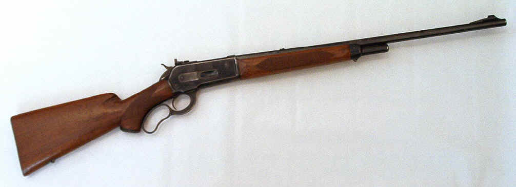

It was introduced in two different models, the Standard and the Deluxe versions and was produced in 2 barrel lengths, 20" and 24" (carbine & rifle). Both models used a pistol-grip stock. The Deluxe version had checkering on the forend and stock, along with snap-on sling swivels, pistol-grip cap and a really cool bolt mounted aperture sight.

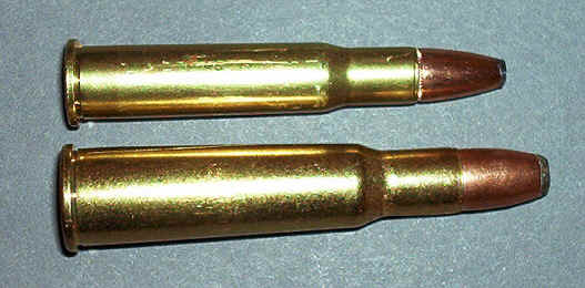

.30-30 and the .348
The 348 was based on the old .50-110 WCF cartridge and is the largest-sized rim diameter used in factory leverguns. Original loadings for the .348 were in 2 different bullet weights: 150 gr. and 200 grain jacketed. (The 250 gr. loading was added later on.) The velocity's listed originally for the 150 gr. and 200 gr. loads were 2920 fps and 2535 fps. These were later reduced to 2890 for the 150 gr. and 2530 for the 200 grain loads. The 250 gr. loading which was introduced some time after the 150 gr. and 200gr. loads was rated at 2350 fps.

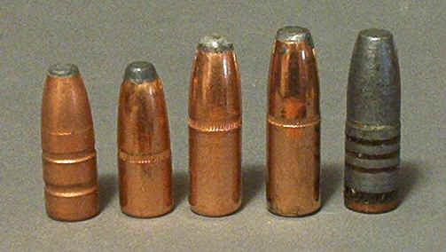

Left to Right - old Winchester 200 gr./ Hornady 200 gr./ Barnes 250 gr./ Alaskan Bullet Works 250 gr. / 250 gr. cast gascheck (I had a few of the original 150 bullets but never got a photo)
Handloaders do not have a large selection of bullets to choose from. Hornady makes a 200 gr. JSP bullet. Barnes produces a 220 gr. and a 250 gr. bullet. Alaska Bullet Works makes a 250 gr. bullet also. Limited testing that I have done shows this to be a tough bullet that should work well on large and/or dangerous game.
There are several bullet molds available for the .348" diameter projectile. I don't know of too many people who use this caliber, let alone cast bullets for it. I have used the gun for some years and even though I have a bullet mold and dies, I have yet to run cast bullets in the gun. As little as I use it I prefer my own handloads with jacketed ammo. Most of the game I have taken with it have been with original Winchester 200 gr. Silvertips. I know that on large Mule Deer the Winchester loading worked just fine.

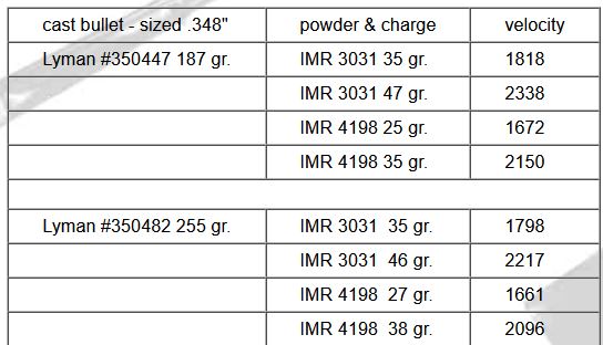

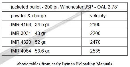

LOADS

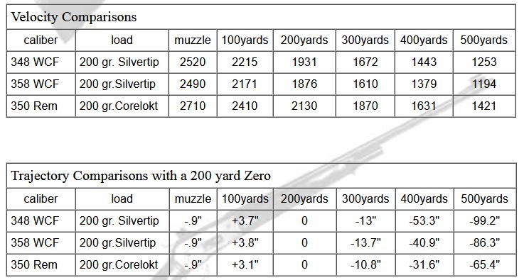

Ballistically .. at least on paper .. the .348 Winchester falls somewhere between the .350 Remington Magnum and the .358 Winchester I say "on paper" since in real life the paper figures do not always turn out to be totally true. For all practical purposes the .358 gives identical performance as the .348 Winchester.
With a 200 yard zero you can basically hold "on" to 250 yards. That is further than I would take a shot at game animals, using the iron sights. To be fair the to animal I would stalk closer.

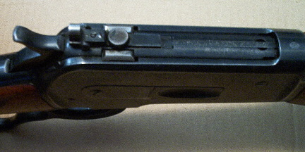

Bettter photo of rifle and the rear sight
- Jim Taylor, 2022-03-21, 07:31
That's a pretty gun! Prices have skyrocketed
- WB, 2022-03-21, 08:03
- Adjustment if I remember right- never tried to remove it. (nm) - Jim Taylor, 2022-03-21, 08:19
