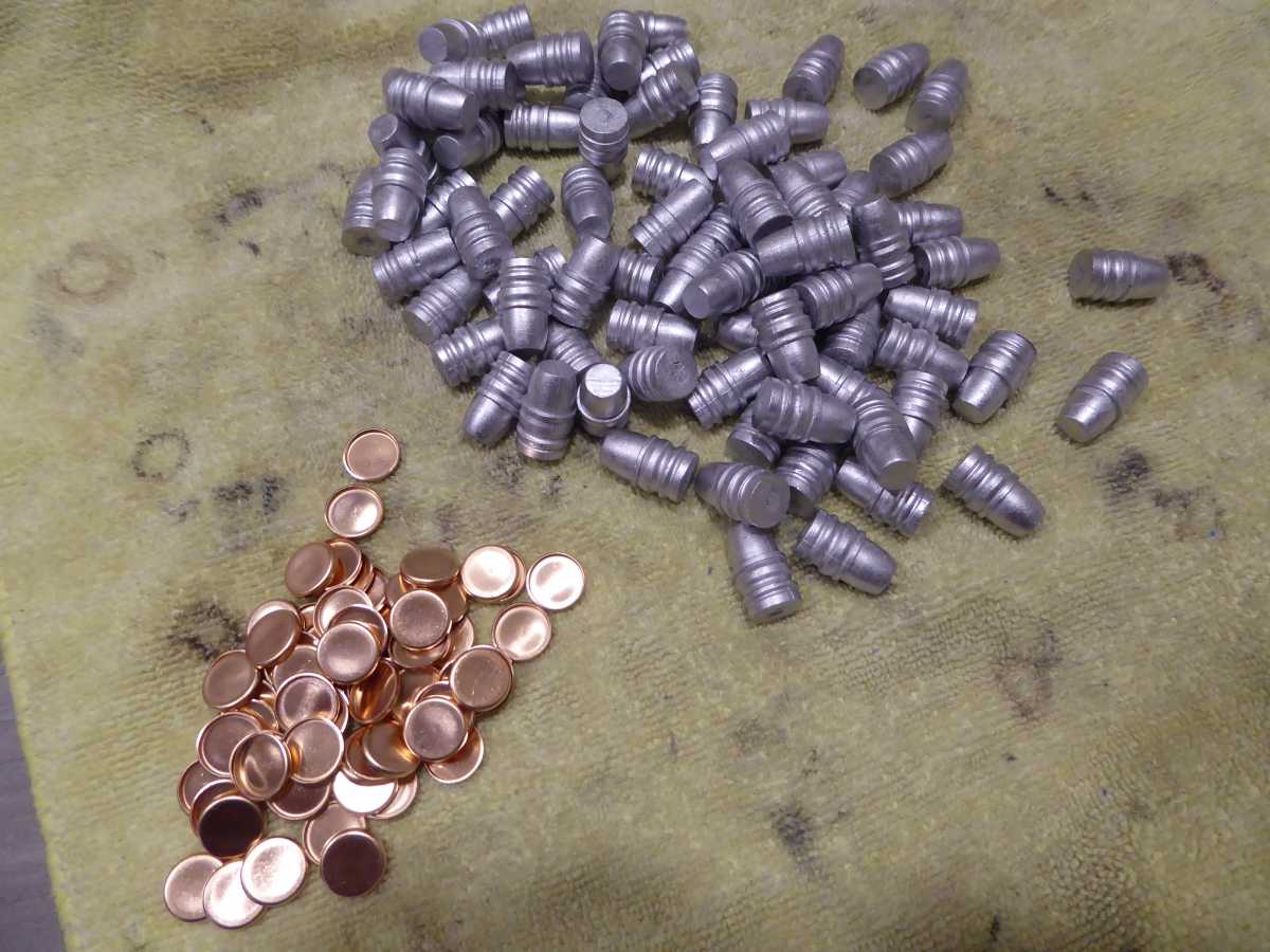

I've had this mould for ages, don't know for sure when or where I got it.
Today I decided to cast a few of them. I did not want or need many, just a few to play with. Cast about 80 of them.

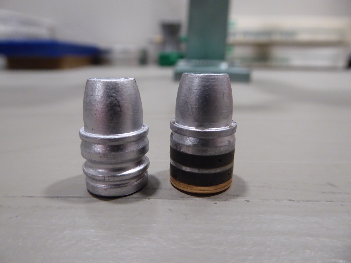

This is where it starts getting a bit interesting. The bullet drops from the mould at 260 grains with my alloy. Sized, checked and lubed is about 270 grains. The front drive band is about .450-.451, I think pretty common for Ray Thompson's designs to have an under sized front drive band. I think his theory was easier alignment going into the barrel. The main drive bands are just barely .452.
![[image]](images/uploaded/202204212122316261cb178653b.jpg)
These will be shot in the 455 GNR and compared to Elmer's 454424 and some LBT LFN's.

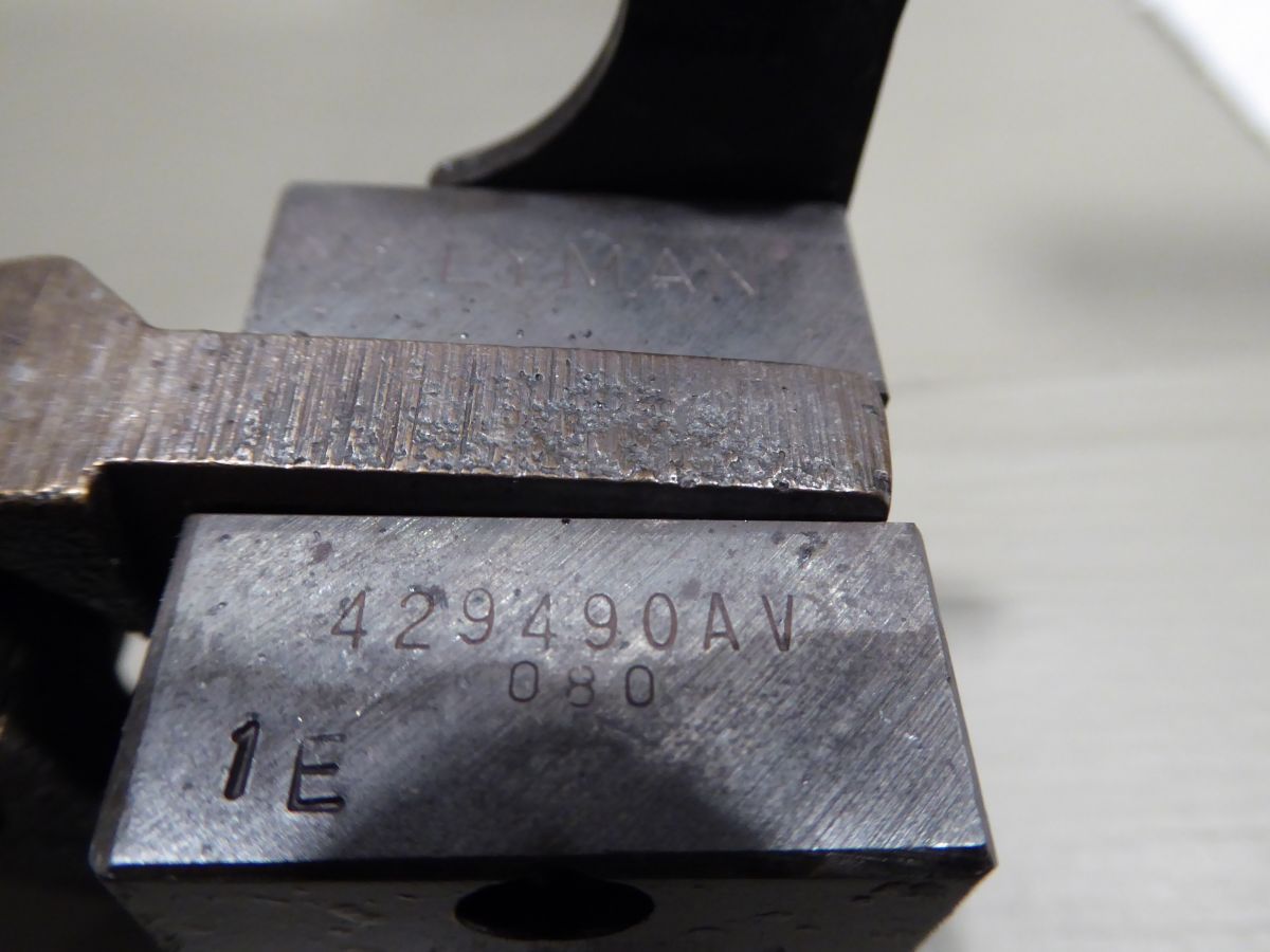

Who's gunna figure this one out?
- Mark Conner, 2022-04-21, 14:39
MOLD NUMBER "429" SHOULD BE A .44!?!?!? (nm)
- JT, 2022-04-21, 15:33
- Yep, should be 429. - Mark Conner, 2022-04-21, 15:41
You know the narrow part of the bore
- WB, 2022-04-21, 15:30
- The throats on my 455 - Mark Conner, 2022-04-21, 15:50
