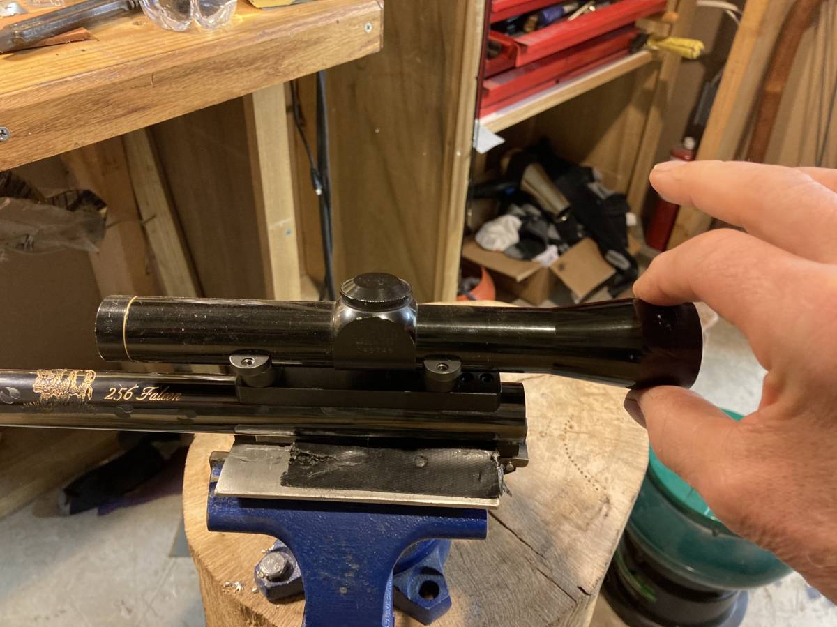

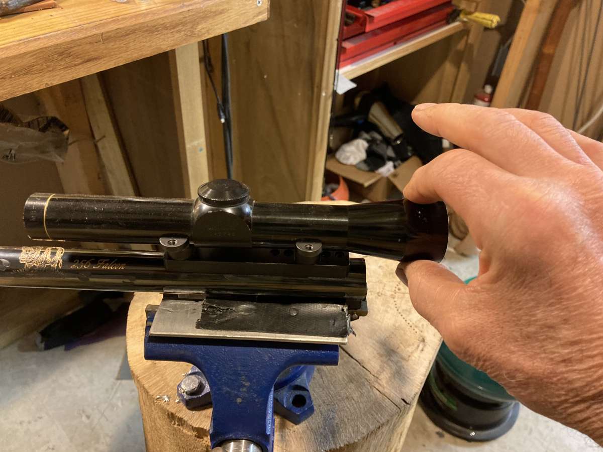

Bar stock. I use it to Turn rings in with, and align the bottom two halves. Once the rings are pretty close, you can tap the the rod down on both rings and it will bring them both into alignment. After that the scope will lay down in the rings with out binding and will glide back and forth with out resistance.
![[image]](images/uploaded/20220606160750629e2656c314b.jpg)
![[image]](images/uploaded/20220606160835629e26839267a.jpg)
![[image]](images/uploaded/20220606160857629e26998e477.jpg)
